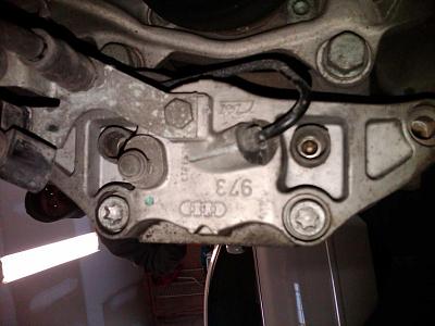

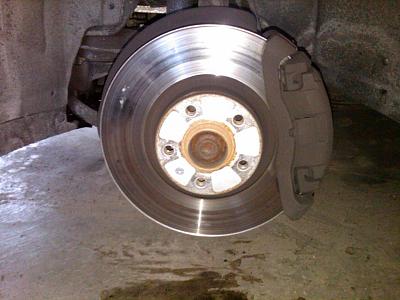

Does any know where i can go to find out how or know how to change the front brakes on my 2005 C6 A6?? Having some trouble.. Thanks!
This is how far I've gotten so far..
Attached Thumbnails Changing the Front Brakes 2005 A6-img00013-20101220-1255.jpg   Changing the Front Brakes 2005 A6-img00018-20101220-1336.jpg

You have to pull the two bolts that hold the caliper bracket to the spindle.

Thank you, i figured that out right after I made the post. Took me a little bit though...ha
