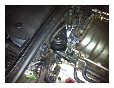

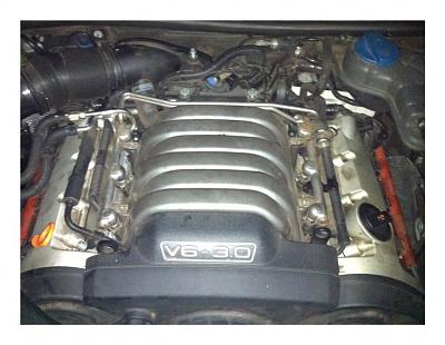

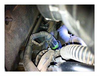

Thanks for the replies! so right you don't remove the intake! Tight spot though, I got a hold of it however i could not work it out [YET]. I was really there for photos and only spent 10 minutes with my hand buried, twisted jammed & skinned in the rear of my fiance's engine!
Attached Thumbnails Coolant Temp Sensor replacement 2003 A6 3.0 65k-engine.jpg   Coolant Temp Sensor replacement 2003 A6 3.0 65k-coolant-temp-sensor.jpg   Coolant Temp Sensor replacement 2003 A6 3.0 65k-intake-pipe-removed-.jpg   Coolant Temp Sensor replacement 2003 A6 3.0 65k-hand-angle.jpg
Old Feb 24, 2011 | 05:15 PM
Tiyal's Avatar
Joined: Feb 2011
Posts: 9
From: Deep in the Pacific
Victory! small screw diver freed the C clip. The sensor was trashed and the o ring was nothing but grease {disintegrated}. Check engine has not gone off how ever Ive not test driven it either. To Victor Goes Horsepower!
