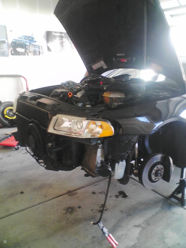

You mean the engine snub mount? Its far from foam, its super heady rubber. You would have to slide the front end forwards on a 3.0L, but you wouldn't have to disconnect and coolant lines to do it. When you remove the bumper, there is two very long allan bolts that hold the bumper to the crash beam, save these bolts and install one on each side after removing the large green torx bolts holding the lock carrier to the front of the car.
Here is a pic of my old B5 S4 in this position. It only takes about 30 minutes to do.
