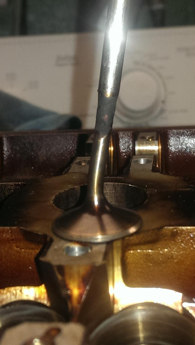

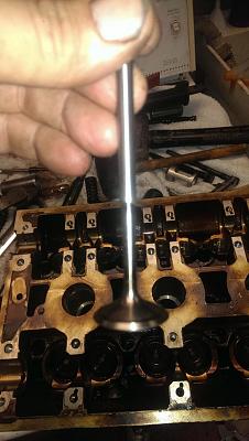

Got head tore down removed bent valve only question I have is what do I use to seal cam carrier back to head ?? Will Indian head gasket shellac work ??
Attached Thumbnails help 3.0 engine no compression might need new engine-imag0275.jpg   help 3.0 engine no compression might need new engine-imag0274.jpg

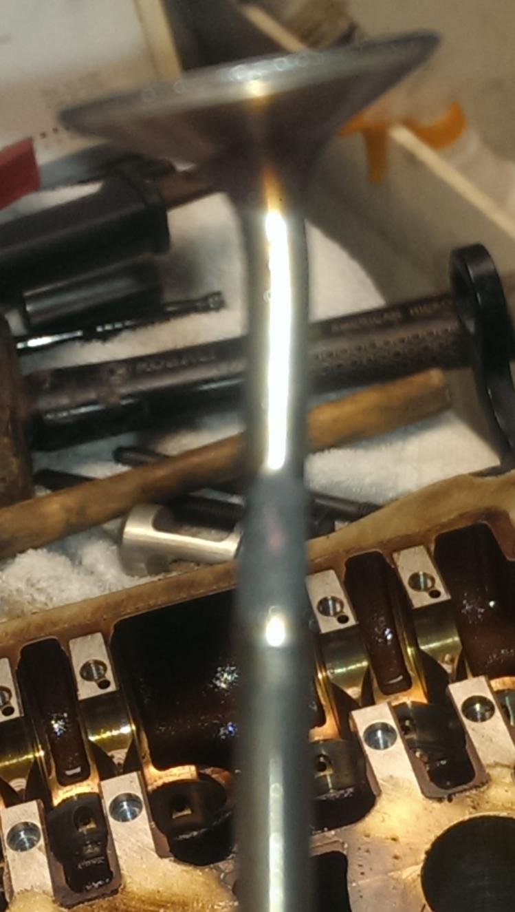

New valve came in quick 1 day
Attached Thumbnails help 3.0 engine no compression might need new engine-1385005238964.jpg

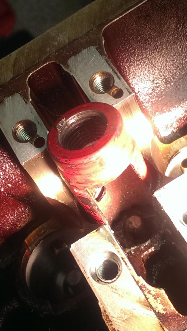

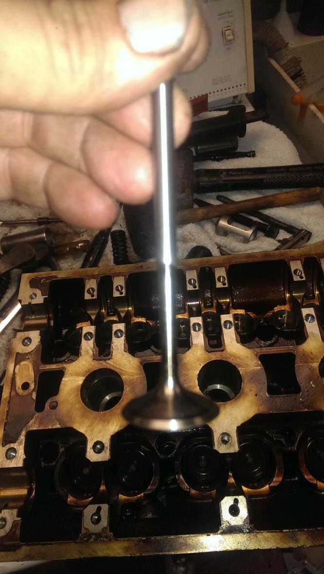

New valve in had to make tool it was a 7/8 hole saw . Used spring compressor on top of that was able to get keepers back in .
Attached Thumbnails help 3.0 engine no compression might need new engine-1385048904280.jpg
