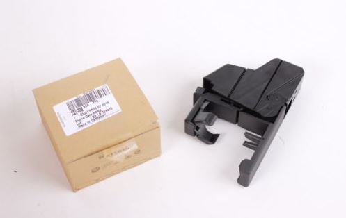

Hi--I have a coin tray in my A6 and had one of these pop up cupholders in a past Audi, which I loved (amazingly it never broke, which it sounds like is common!). I found a cupholder pullout on ebay thinking that I could replace my coin tray with the holder since it's hard just having the one cupholder on the dash next to the four-way button, but after reading this series, I was wondering if switching from tray to cupholder requires more hardware than just this insert. I know some of you have mentioned the "snap in sleeve" the cupholder pops into. Can anyone who has maybe gone from cupholder to coin tray let me know if going the opposite direction is viable? I'm attaching the picture of the insert that I could purchase in case someone can recognize if there's an additional part needed. Thanks very much.
