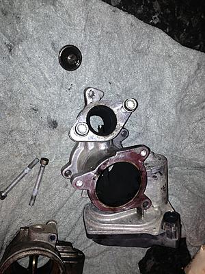

Hi.
I sorted it out.
It was the EGR valve. The valve itself has snapped inside so was letting exhaust fumes through all the time, suffocating the engine until the revs got up.
The picture shows the problem. The black disc at the top of the photo is the vavle and should fit in the unit. Cost my about £140 from ebay and 40min to fit. Not a big job.
Hope this helps.
