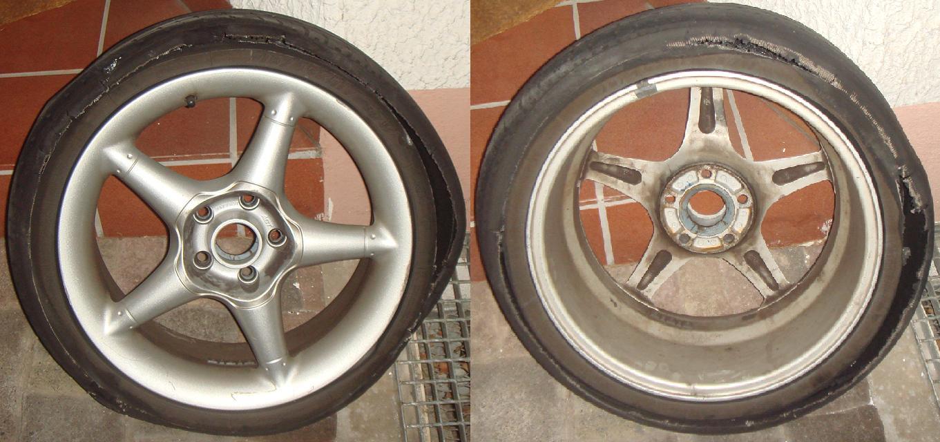

This is the tire I had to replace, I thought maybe some of you would like to see just how bad it was shredded. No idea how it happened, it made the car shake like hell but I went ahead and drove the last mile home since there's nowhere to pull over and change a tire in Germany

were they remoulds? or curbed what were the make of the tyres?

They were Goodyear tires. As you can see they were getting worn down a bit. The road I was on was pretty bumpy and it was dark so no idea if I hit something on the road or if it was a pothole or what. I didn't notice the flat until I got off the bumpy road and it was still bumpy haha.
