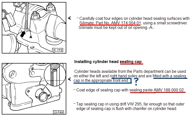

Bentley manual talks about brushing lightly

Also, they talk about
I would assume they still talk about the mating surface with the valve cover gasket, since they show a pic of the head's top, with the camshaft.

Lastly, beside the fact that Bentley is extremely confusing concerning the right "end" of the head, the coolant pipe O-ring's edge suppose to be coated with yet a different type of sealant paste: AMV 188 000 02
Since a p[icture is worth a thousand words, here's the confusion I was refering to:
They show the rear end of the head where the coolant pipe slides in, yet it refers to the same O-ring as
carefully coat(ing) four edges on cylinder head sealing surfaces with Silimate, Part No. AMV 174 004 01 using a small screwdriver
a sealing cap in the appropriate front end

silicone lubricant D 007 000 04 = Silicone grease.. Basically helps the gasket move and settle while tightening. Just about any will work.
Black works..but look below.
Not O-ring. Those are where you put the Freeze Plugs you bought. You can use Permatex Hi-Tac or INDIAN HEAD Shellack. Blue or green Loc-tite works too
Tell you what I use instead of RTV on the valve cover, oil pan, and tranny gaskets is some stuff called 'The Right Stuff' from Permatex. Works great as an all around sealant and gasket maker - you can place the car back into service in 1-2 minutes. You can use it on the Freeze Plugs too.. I love this stuff.

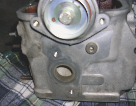

As far as the "confusion", I had to go and take some pics.

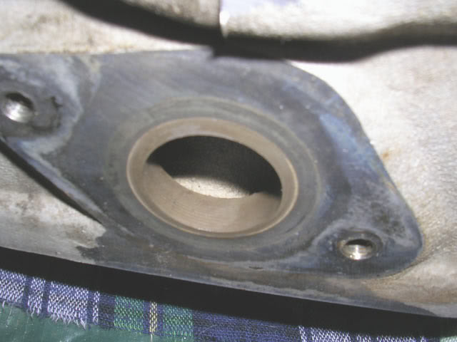

In the Bentley illustration, the area of that "sealing cap" looks exactly as the "flange-like" diamond shaped area where the coolant pipes fasten to the heads rear.

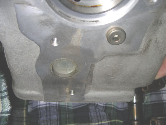

The front of the heads have indeed freeze plugs, but they don't look anything alike the ones I purchased (listed for my car....lol), and the area is "shaved", doesn't really resemble a diamond-like shaped "flange".
That's where the confusion came from.
When you say "elephant", most people around the globe know what that represents.
"Sealing cap" didn't sound to me like "freeze plug" (I asked long time ago where the heck the freeze plugs are located and the question remained in the air), and the illustration threw me off.

freeze plugs in my heads vs purchased freeze plugs - Driver side head front:
Passenger side head front (no diamond-like shaped resemblance to Bentley's illustration):
Driver Side head rear:
