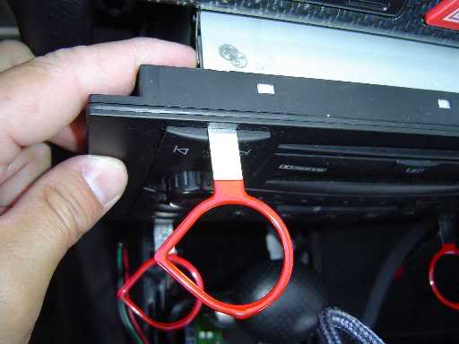

This picture should help you locate the slots for the radio keys:
Once the keys are clicked into place, insert a few fingers into the cassette slot and pull from there. Do not pull the radio keys themselves...you risk bending one of the clips and making it even MORE difficult to remove the radio.
To re-install the headunit, remove the keys first, then just slide the unit back into place and make sure all 4 clips click into place. To remove the keys, press the locking clip from the side to release the groove in the key:
