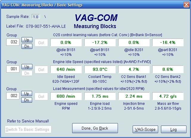

I looked at the article you posted about the MAF and did a block group 032 it seems out of tolerance
cheers

It is just telling you that you are burning rich. One way of check is to just disconnect the MAF and check the measuring block 32 to see if you get the same result. If you do get the same result than it probably is not a MAF. If the o2 level goes up, then you probably have a bunk MAF.
Old Sep 24, 2009 | 07:24 PM
  #19
porschefan's Avatar
Joined: Jul 2009
Posts: 50
I disconnected the MAF and ran it again. Both 032 values dropped to -25%
The 001 O2 banks fluctuated between -5 & +10%
