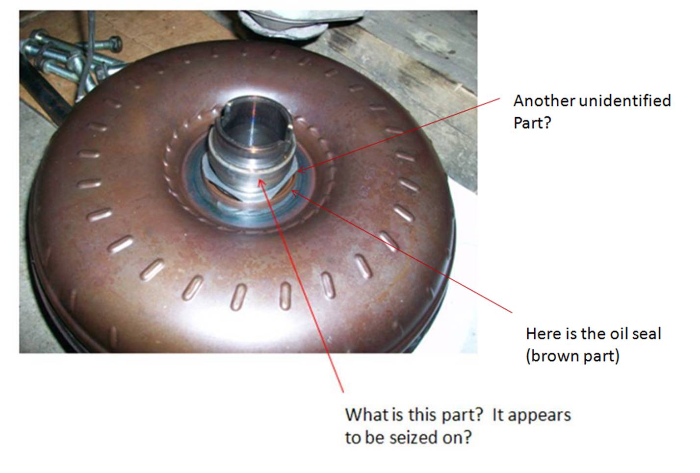

So I think I need a new torque convertor. When I pulled mine....The oil seal is behind the part in the pic. I am thinking about getting a new TC but am trying to figure out what the part in my pic is

final TC seal, belongs on the trans side of the spearation, you can buy that seal separately, does your TC throw any codes? Are you upgrading turbos? If not then get that seal replaced and call it a day

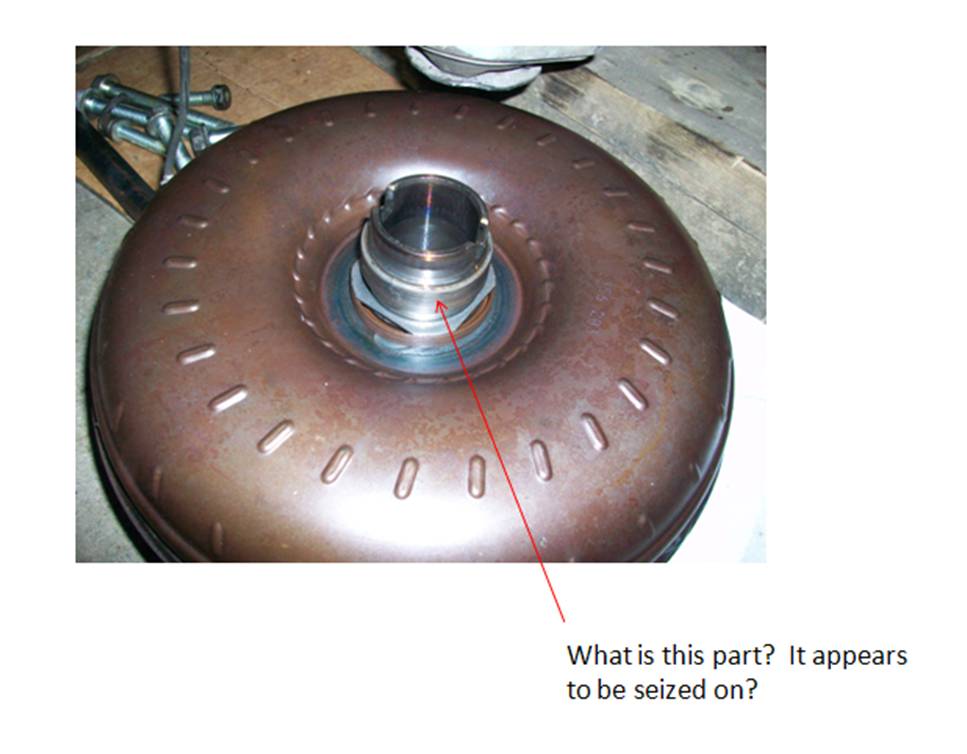

Thanks for the info! The problem I am having is that it appears a bearing is froze up on the torque convertor shaft, I can't get seal off.

see the attached pic
