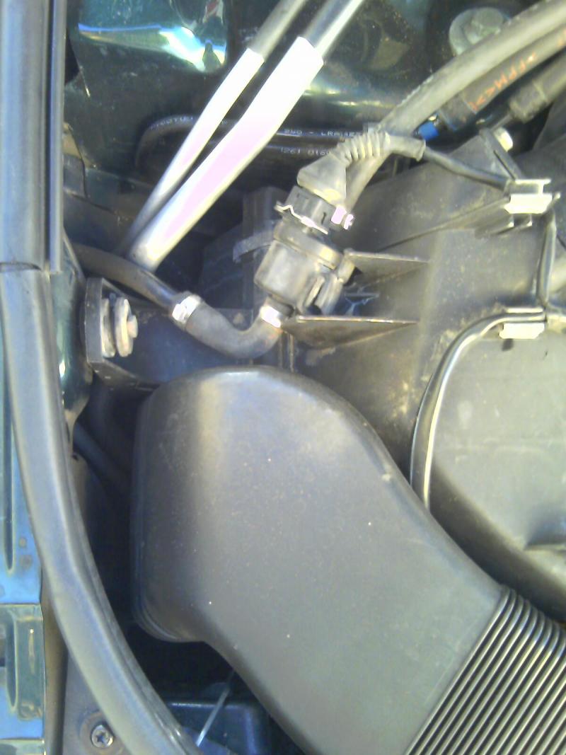

Ok here is what I found. The EVAP valve is not clicking like I read it was supposed to be. So that might be the problem with that. just to be sure I added a pic of what I think the Evap valve is (first pic).

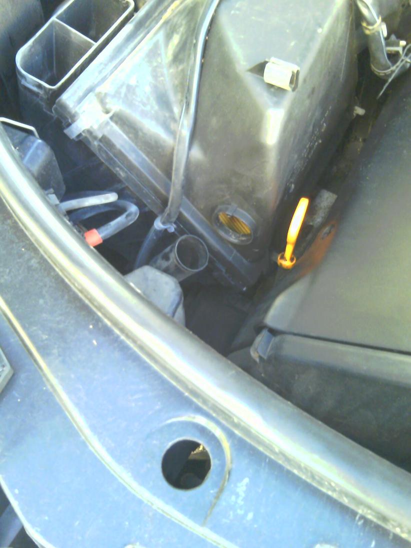

Secondly I found that there is a what looks like an elbow, missing between the the Secondary Vacuum Pump and the Air Cleaner Box. (see second pic)
I know that the missing hose is very bad but could it cause the CEL to turn on with these codes, or could it be that the EVAP valve is bad?

The picture you show is the purge valve. I am pretty sure the code is on because of the purge valve, not the secondary air hose. The purge valve will probably cost you about $100 to $150.
FYI, not having the secondary air hose will mess with your warm-up cycle, and suck in dirty air.
