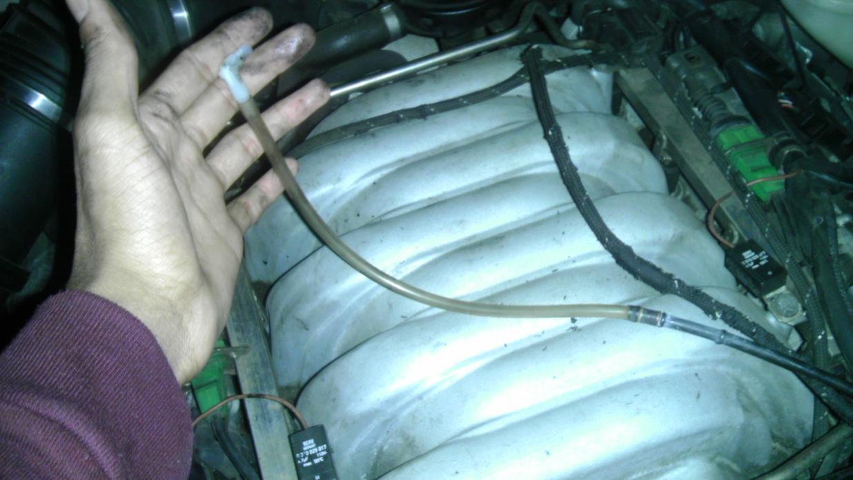

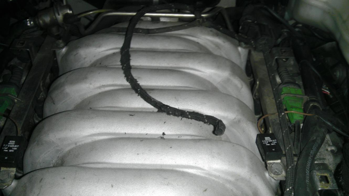

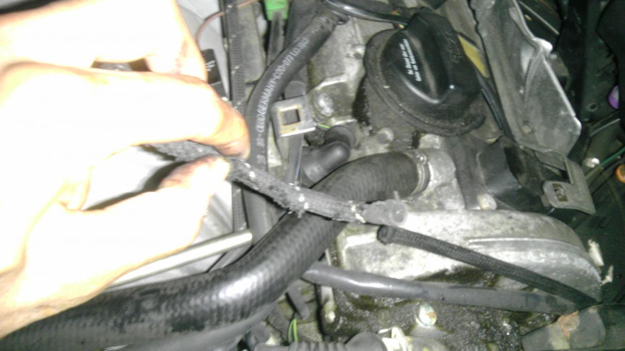

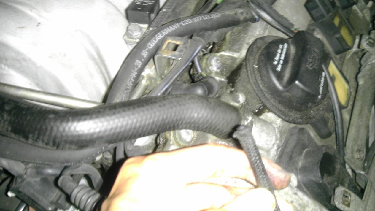

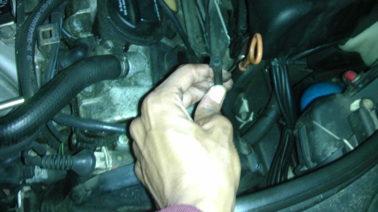

i got codes
p1131
p0160
p1423
p1113
and my fuel gauges doesnt work either it just stop working mysteriously
please can any one tell me what these ropes are and how can i fix them before i get ripped off
thanks in advance

That braided line looks like it goes to the fpr ( fuel pressure regulator)

Sounds and looks like your Vacuum line need to be replace. The vacuum line with set off those codes. The fuel gauges try the fuses.

Could this be causing my fuel guages to stop working?
Also if it's a fuse which on is it?
