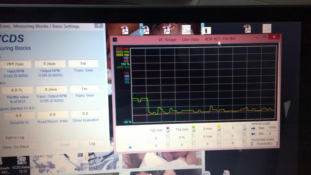

There's probably some more that I'm not thinking of. I also have the VAG-COM scanner that is giving me code 17114? Gear ratio incorrect.
Now, I checked out with the VAG-COM and graphed my vehicle speed sensors to see how they were acting when I was in park, neutral, and drive. The engine RPM is consistent at around 730, while the input is usually bouncing around from 730 - 1500 while in park and neutral. If I shift it into drive, the input goes up to around 2000 rpm and it goes into limp home mode. If I rev up the car while its in drive and limp home, the input and engine rpm readings match exactly. A perfect matched curve is present on the graph.
So not in limp home - rpms random on input speed sensor
In limp home and 5th gear- rev it up and the two readings match. Come back to an idle and the reading is sporadic again.
I'm guessing this is my issue, but what does this mean? Is the "a" clutch bad? Is the valve body not pressurizing the "a" clutch enough? Is there a wiring fault? I never tested the male connector going to the transmission, but it did have corrosion in there like the valve body harness connector did.
