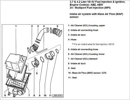

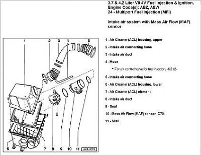

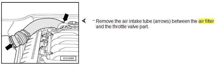

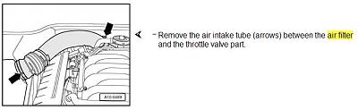

Default do this:
l think if memory serves me best that there's
four screws to open the air filter box. you
will have to remove the air intake hose first.
hope this helps
Attached Thumbnails 2000 A8 Air Filter: How access air box screw?-remove-air-intake-tubing.jpg   2000 A8 Air Filter: How access air box screw?-intake-air-system-v2.jpg

Nulif7: Thanks for your reply. Your attached thumbnail shows the wrong air duct. It shows the duct between the air filter housing and the throttle valve. This is not the air duct that blocks access to the air housing screw. The correct air duct is the one which is between the top of the radiator and the bottom of the air filter housing. Do you have a diagram that shows how to remove it?
