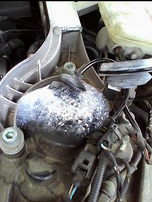

Update: did the soapy water test at the top of the valve and driver aide front one is leakingOriginally Posted by jakematic

I remove both rubber boot off the top of the shock m pour the soapy water there and nothing but bubbles so I'm not sure..Originally Posted by jakematic
Not sure if you mean the valve block or the valve on the shock itself.If block, then try sealing it or replace.
As for the air shock this is your best bet: https://www.arnottindustries.com/par...17_pid174.html
Ideas ?

Pic attached

Pic attached
Quote:
Uhhhhh, yeah.... that's likely a new air shock Originally Posted by jam2220
Pic attached
Check the connection just to be on the safe side though.
Some folks claim you can put some 'slime' (?) in there that's similar to Fix-A-Flat.
Don't do that please, it will just make things worse eventually.
