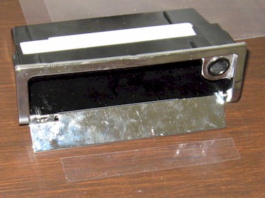

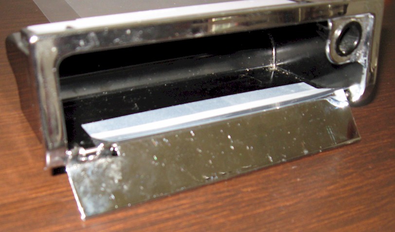

The first mod addresses one of my main annoyances with my car ... the ash tray. I don't smoke, so I don't need an ash tray. However, I do tend to keep a bunch of change in my car, and the ash tray is a logical storage area for it. Unfortunately the lip on the tray makes it extremely difficult to get coins back out of the tray. On to the fix:

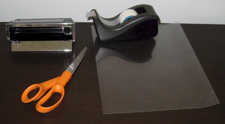

Materials needed:
- Ash tray
- Scissors
- Thin sheet of plastic (I used a clear binder cover)
- Clear tape
Step 1: Remove ash tray from car (it pulls right out)

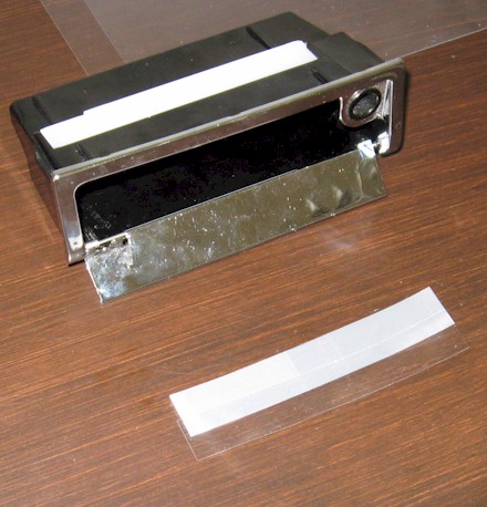

Step 2: Cut out a small strip of plastic, spanning the distance from the cigarette holder to the right side of the ash tray (~ 4.625" x .75" or 117mm x 20mm)
Step 3: Affix a piece of tape spanning the width of the plastic strip to one side of the strip.

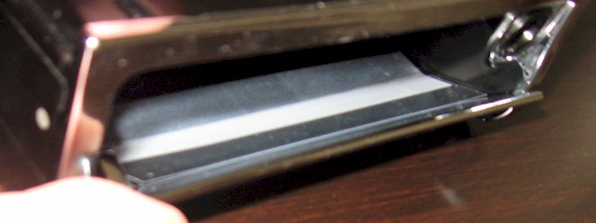

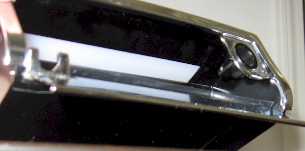

Step 4: Insert the plastic strip into the open ash tray, with about a 2mm (~1/16th") overlap and affix the tape to the ash tray.
Voila!
