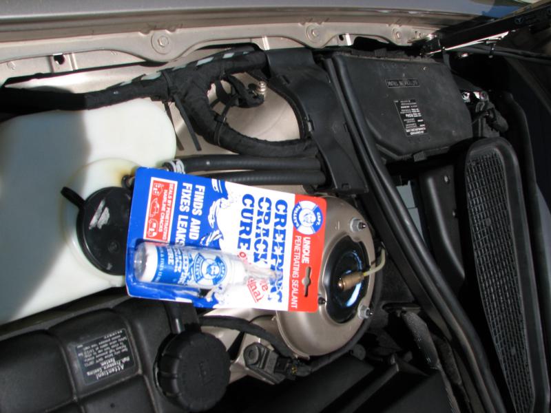

Here is a pic of where I realised air is coming out from. Is there any easy fix to this?. Also I plan to rebuild the compressor how difficult of a task was it?

Only fix for that is to replace the air shock. As for the airpump it took me 15 minutes to swap the parts in it.

im a member on benzworld forum and i saw where someone had the same issue with their strut at the top and used a product to seal it and he claimed it worked for him, any idea if this might work or jb weld like some other people claim?
ps...ordered the rebuild kit for the compressor

so sorry for the late reply i just got to see this. i replaced the shock yesterday and it works okay but seems like the compressor is bad as it keeps doing the same thing trying to lift up and making the loud noise. i went to oreilly and bought a stop leak (epoxy for metal) thing that has a syringe-like tip to push it out and it helped with the leak but apparently my leak was really bad so that didnt fix my issue, the car was sitting till i came up on a strut for 250 shipped and i just replaced it. now i will try to do the compressor thing tomorrow and see if that fixes my issue, keeping my fingers crossed
