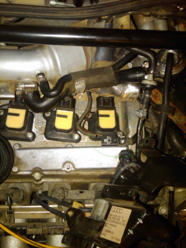

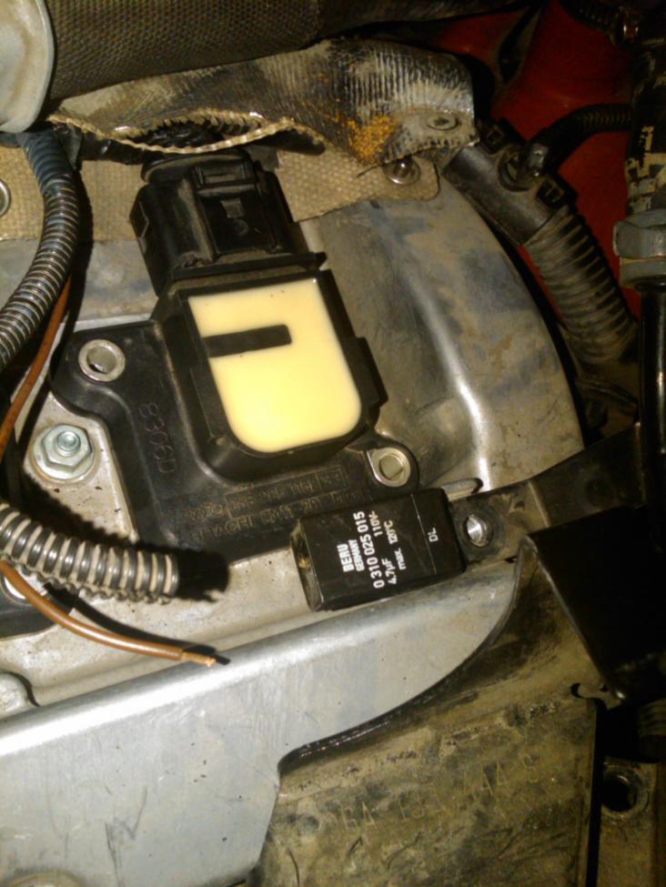

Anyone who what part this is? Or where I can get it? The wire broke off the back when I was changing out the spark plugs. It’s the part that’s under the rats nest of vacuum lines on the valve cover.

It's a capacitor
other than that I dunno
Old May 1, 2010 | 07:33 PM
jakej's Avatar
Joined: Feb 2007
Posts: 1,049
From: Milwaukee
^^^ Correct. Its to prevent the coil packs and plug wires from causing static on your radio. You'll be fine without it.
