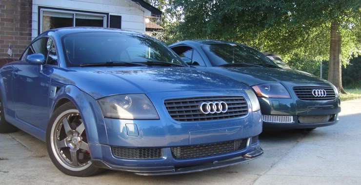

As some of you know... I have two TT's; I have my original green 2001 TT Quattro that I've had for nearly 8 years now, and I also have Matt's (skitzafit) Blue FWD TT thats fully built (Engine stroked, new valves, springs, pistons, cam, rods... GT3076r turbo, 3" turbo back Exhaust, Blistein PSS-9 coilovers, etc.
