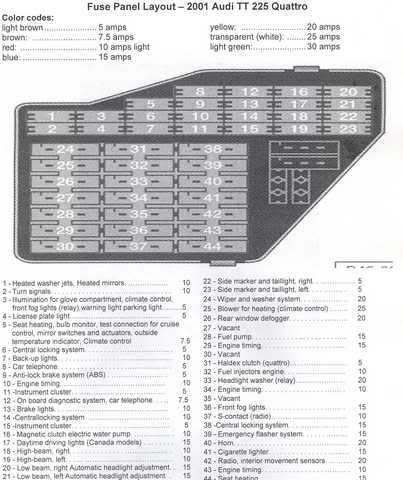

How about you check your haldex fuse...position 31

EPC reduces power in the event of some sort of failure that the car sees as threatening to the engine, its not speed control exactly, although you will be slowed down. Think of it as super limp mode.
As for the haldex issue, run the roll out test, but it sounds like you've done a pretty good job of varifying that its not hooking up.
You'll need to check the car for DTC's, I'd almost put money on you finding 'internal memory malfunction' or something along those lines, I can't remember exactly what the code is called. Far as I know in that case, is theres not really a repair for the controller, you'd need to replace it. I went thru the same thing, snagged a Haldex blue controller for $750. Easy install at least. That splits power more 50/50, and I wish I had a video camera last night when I was doing donuts in the parking lot. The car eventually gets into a fast spin pivoting around a point almost centered in the car. Wild.
