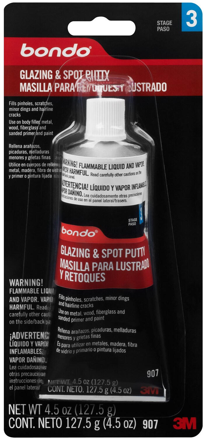

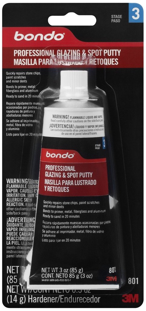

I started by cutting up some strips of fiberglass cloth I had from my RC hobby supplies. I used 5 minute epoxy together with the fiberglass strips and applied several layers to build up the edges. It took about 5 applications, sanding and shaping in between each one. When I was happy with the fitment I applied 3M Professional Glazing and Spot Putty, which comes in a tube with a hardener you mix together with the putty. It sanded easily and worked really well to get a nice smooth finish. Finally I applied 3M Glazing Spot Putty to all the small pinholes etc. The difference with this one is that it doesn't have the hardener and isn't meant for larger ares. You really need both products to achieve the best results.
