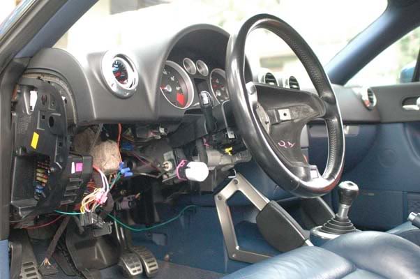

Here's some photos of what's going on...

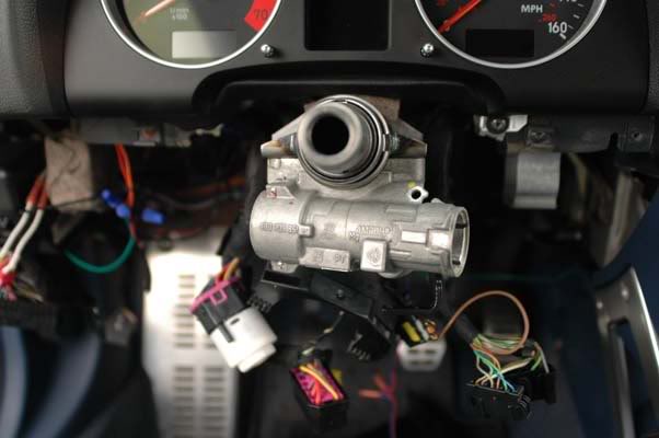

that's where I am. Both Ignition Switch and Ignition Lock Column are out.

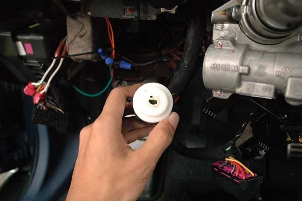

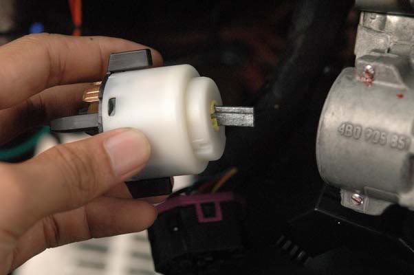

Ignition switch didn't want to turn before, for some reason, now it turns and I can start the car with a flatscrewdriver

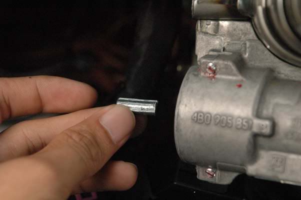

the metal piece that broke off and where in the Ignition Switch Housing it belongs
where it's supposed to go...
ignition switch housing, where the metal part broke off from...
This is my current driving setup, except airbag/horn, knee board and fuse cover are installed. It looks cleaner now than this picture but I turn on the car with a screw driver. At least she's drivable.

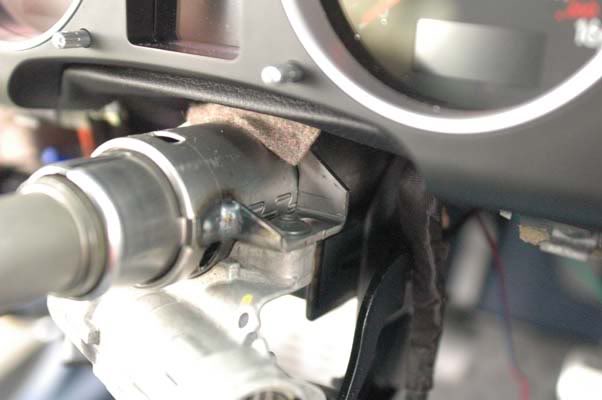

Next step is to try to cold weld the metal piece back to where it came from. If not, I have to figure out how to remove these:
it looks like they weren't meant to be removed but this might be what I need to replace. Any Ideas, diagrams, etc would be awesome at this point.

They're shear bolts.. You crank them until the heads pop off. : (
Don't see why a standard bolt wouldn't work, just make sure the thing isn't gonna come loose on ya.[*]Drill out or, if necessary, chisel out shear bolts and remove ignition lock housing.[*]When installing, note the following points:[*]Insert ignition lock housing and secure with new shear bolts.[*]Tighten shear bolts until heads shear off.[*]Connect connector for ignition lock and immobilizer[*]Align steering column switch with steering wheel and tighten.[*]Install upper and lower gap cover[*]Install upper and lower trim for steering column switch. [/ul]BTW, steering wheel bolt is apparently supposed to be replaced if you take the steering wheel off, and its supposed to be torqued to 50Nm
