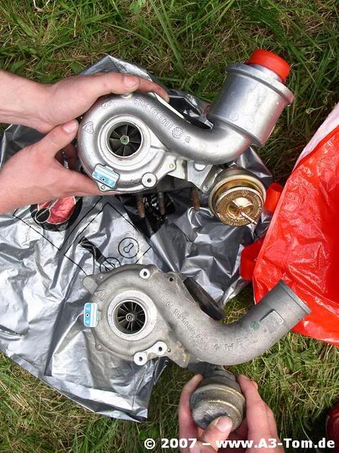

Both the housings are different on the longitude (A4/Passat) vs transverse (TT, gti, jetta) plateform. The ko3 is the same as the ko3s but the ko3 has 11blade compressor wheel and doesnt have that canister on the compressor outlet.

ko3s top, ko3 bottom

thanks, thats is a perfect picture! so the housing is different, and I need a housing from a transverse engine.

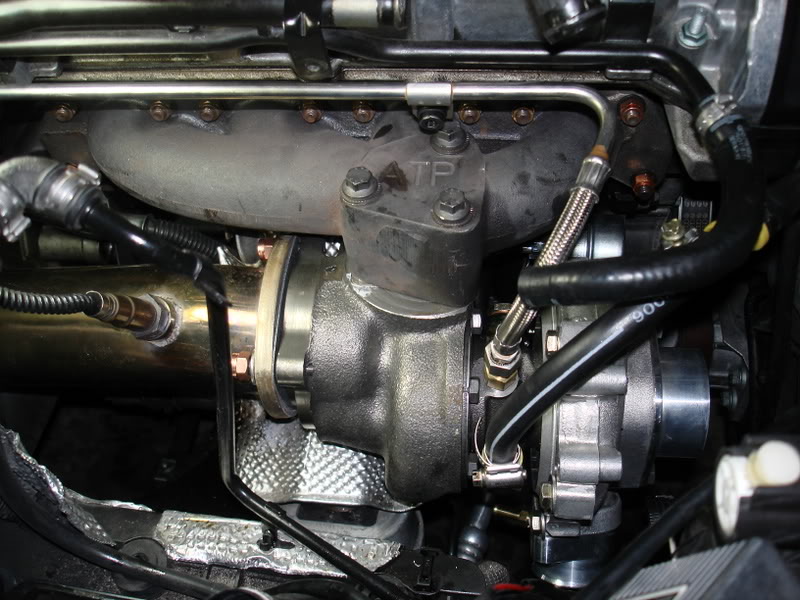

The housings will swap if you have the same size wheel housings.
You cant use that setup since the manifold puts the turbo on the other side (right vs left side of engine) and both housings are completly different
This is how a longitude setup is

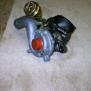

verses a transverse housing
you can see the outlet on the trasverse is down vs to the side on the longitude.
