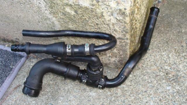

Default pcv problems
About a week ago I asked about the hose under the intake, now I know its part of the pcv system. Below is a picture of achttung's removed pcv mess to illustrate what part i am talking about. I repaired the split in the hose that fits over the barbed fitting on the left side of the picture by wrapping it in rubber hose repair tape and clamping it with a hose clamp. I noticed a difference immediately. my car pulled harder than ever. the check engine light never went away(p1136). now, slowly my boost is going away again. I can actually hear the boost leaking past the DV. Is there a DIY for deleting the pcv crap under the manifold?

achTTung's Avatar
Joined: Sep 2005
Posts: 6,678
From: Colchester, VT
i pretty much posted a parts list in the thread I posted that pic in, so that should get you started. If you didn't want to go with stainless braided hose, you can adapt your fittings and hose to a barbed fitting and rubber hose. That'll save you the trouble of removing the valve cover.
I don't have any pics of the process really, but the guys at audiworld love taking pics of everything.
http://forums.audiworld.com/tt/msgs/1668313.phtml
DIY for replacing the OEM PCV stuff with new OEM PCV stuff, same sequence of removal/installation applies for a lot of what you'll be doing - that writeup doesn't go thru with removing the intake manifold, which I did, for more working room, and to clean the manifold, and area under it even better. Thats your call though.
I'll answer any specific questions you have as well, so feel free to ask.
Oh, one thing I'd do different... right off the top of the block breather, I have a straight hose fitting. A 90° fitting is a little more expensive, but the hose would fit a lot better under the manifold with it.
