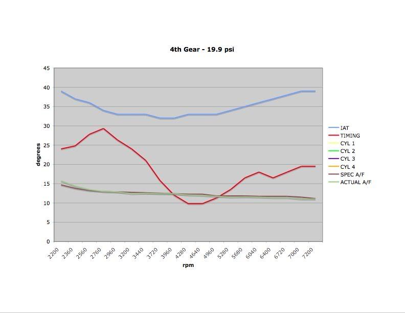

the tunes have a timing curve wriiten into the ecu to a certain max and if the knock sensor and/or iat sensor see certain things, they reduce timing (no contol over boost).
Example
the red line is the timing in relation to rpms. Its high prespool to get the turbo spooled and then dips as if peaks and then picks back up when the turbo starts to level off/fall off, whatever the case may be. It will never increase timing above these limits on its own, just lower them if needed (high intake temps and lower octane gas). This is why you will need to raise it will lemmi, it can easily handle the max and now is able to handle more. The reason you noticed a gain already is your intercooler didnt lower the iats as low as possible and possible the gas isnt high enough octane so a deg or so of timing was removed. This will be the same with stock or BT sw. You have the power to increase it manually if you like, but the sw is wriiten for 93oct and no w/m. You could run a file for 100octane, but that would be worse if you ran out of w/m than just turning up the timing with lemmi.
Hope this helps

another graph with more vag readings
one last one, this you can see some pull in cyl 2-4, and timing is a low 15 at redline [:'(]
