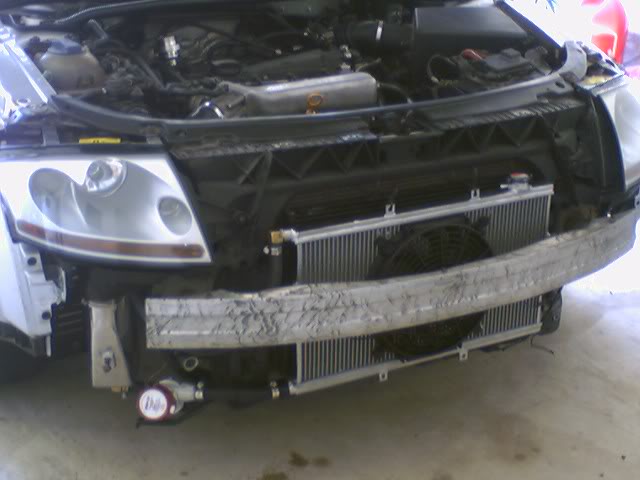

Well if finally got her all put together with a 350hp core. I also ended up making a 2.5" section to the TB since it didnt want to work with the stock TB hose. Only took it on a few passes since i just wanted to make sure there was no leaks and also the front bumper was still off if there was. With only doing a couple of 2nd gear pulls (wind in horns is not a good sound!) it pulled much harder than it did before. You can tell that there isnt a restriction like there was with the stock ic. After i pulled it back in the garage, i stuck my finger in the water and it was still cool to the touch, i just used tap water and put it in the rad an hour+ before the drive. Another thing i noticed was that the fan pushes a crap load of air, enough that it made a large amount of condesation on the a/c hard lines.... TALK ABOUT COLD!
Sorry about the crappy cell pic, the GF takes her camera everywhere. Will also do some logging later on when i have the bumper back installed.

Thanks guys. We are probably looking just under $700 for it. If i can somehow get a discount for buying more at a time, that would certianly drop the price down. Would still like to have a nicer TB replacement section, but other than a few wires that need tied out of the way, its pretty nice. Plus you wont see any of it with the covers and bumper on. If people want to get their own map bungs and attach them like the ebay kits, that could probably cut off another $40-50 also.
