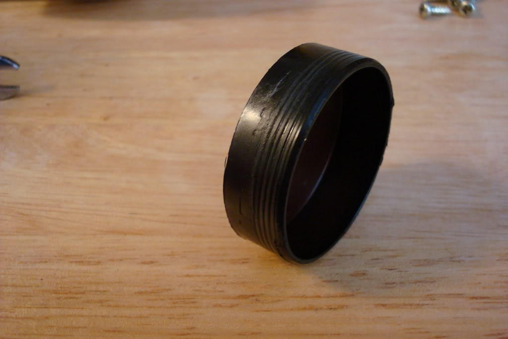

There are 2 different seals in that area. One, is the cam tensioner seal which looks like a half moon and is really hard to see. The second is the cap which covers the end of the cam. If there's a "hole" where that goes it somehow fell out. When I changed mine, I had to loosen up the cam cap that is outside the valve cover, which was a bitch because there's zero room for the torx bit. The only way that I could do it was to take the (T-30)torx bit and put a 1/4" box end wrench over it.
