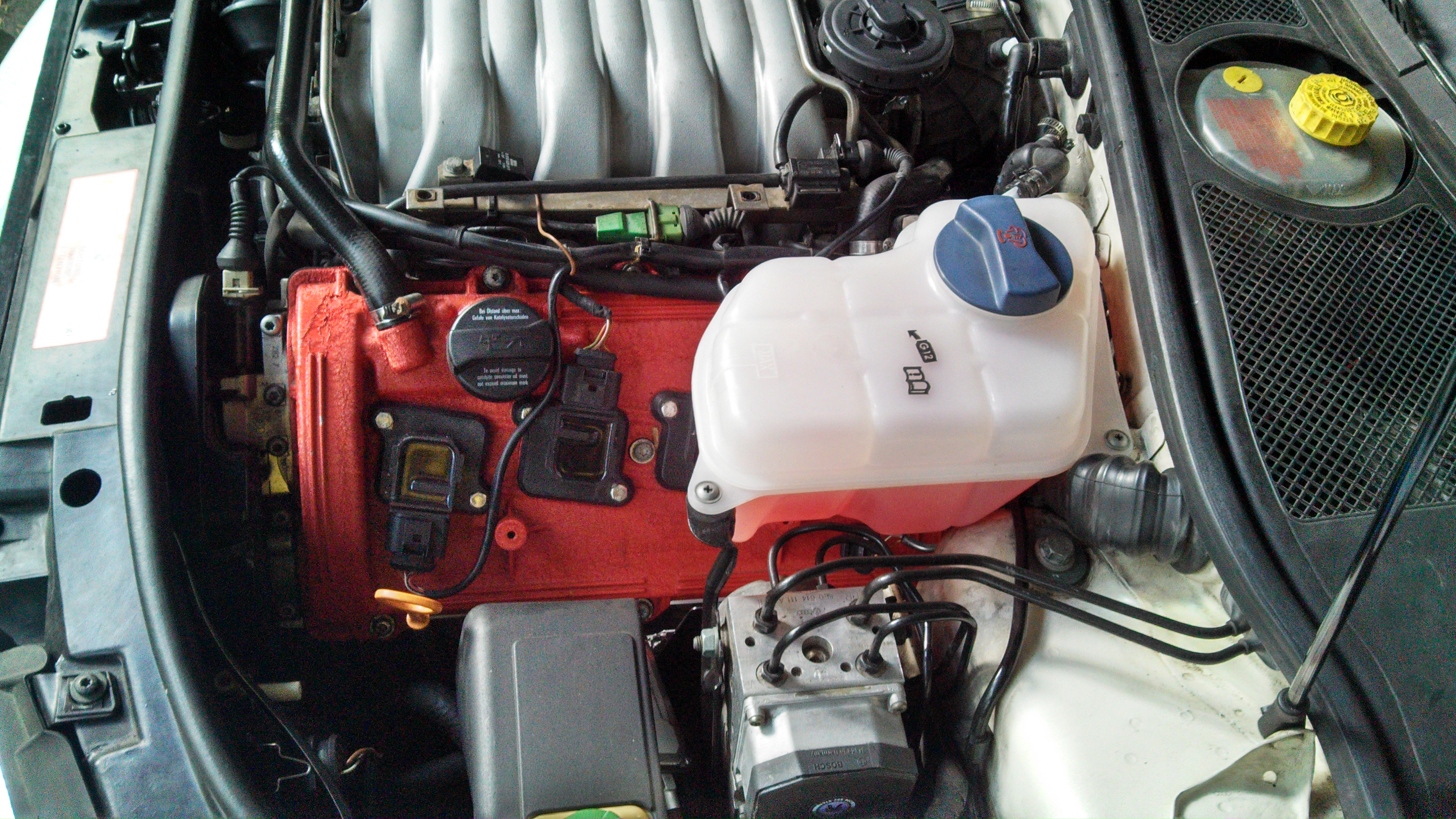

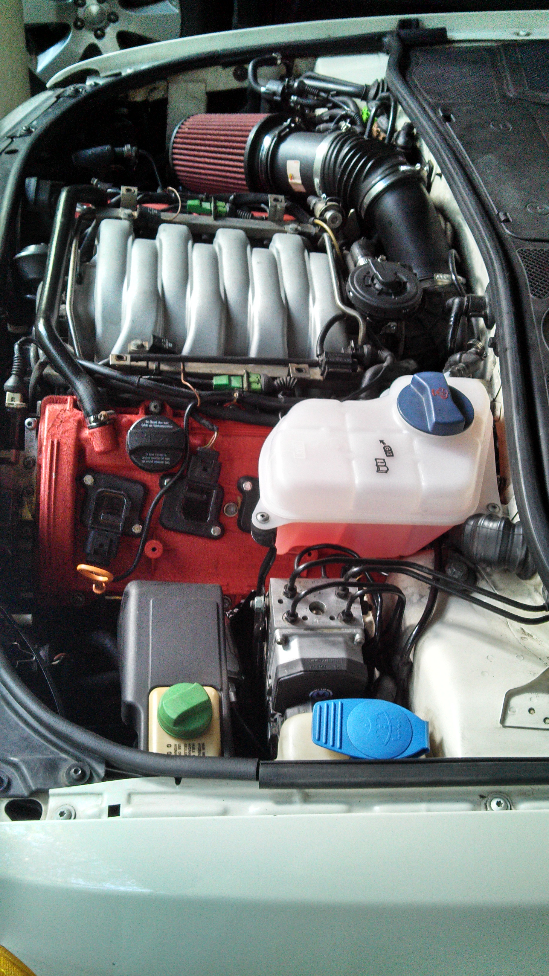

Got my new serpentine pulleys and coolant tank in the mail. Of course this is the same day that the original coolant tank went critical on me. Now I have a nice shiny coolant tank instead of the old yellowed one. I ordered it from partsgeek.com and fully expected a Chinese knockoff for the $56 I spent (everyone else wanted close to $100). The one I received looks to be OEM with the four rings and part number cast into the bottom.
I actually did the tank swap in the parking lot of our apartment (not supposed to work on cars). I didn't want to drive it and have the old one totally explode. Early on a Sunday morning there wasn't anyone around, so I went for it. Used a $4 hand pump from Harbor freight to drain the tank and some plastic line pinch clamps to hold everything else in. Didn't spill a drop. Before someone mentions it, I know I need a new cap...
Later today or tomorrow I'll drive to the garage where I work to pull the bumper/lock carrier and switch out the serpentine pulleys. I've also received my new (used) ECU and just need to put together a harness for bench flashing it to code for manual transmission.
