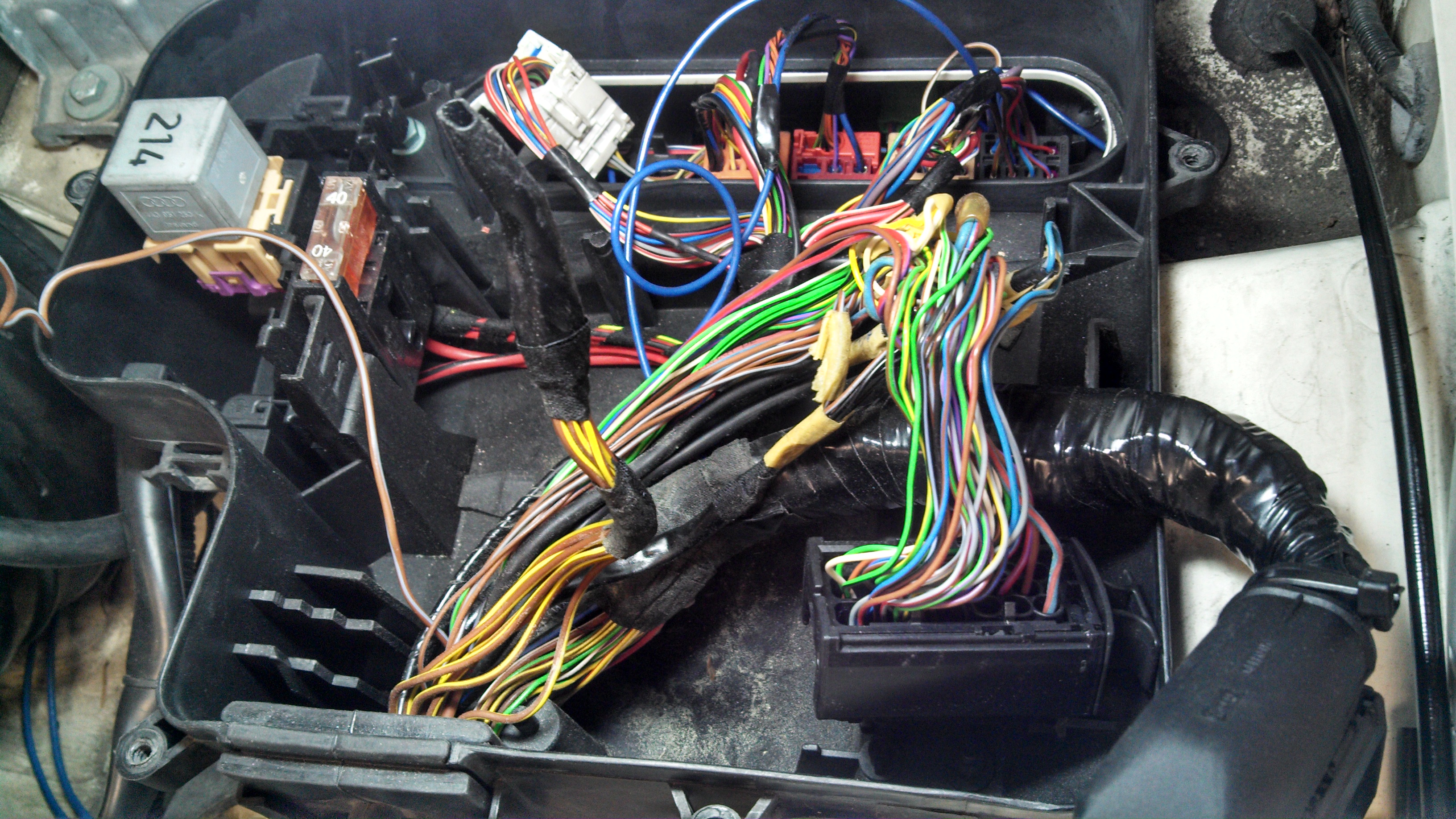

Got started on the wiring changes to run the modified AWN ECU today. Super excited to get rid of the issues caused by the ART ECU. Not so excited to be back to tracking down wires.
Understand that. It is tedious work, and has the potential to create new problems.

Back up and running! With the newer ECU pin 21 apparently needs power through a diode to defeat the immobilizer. I thought that I may have gotten the polarity wrong, but it turns out that the 75x terminal is not hot during start and so the ECU was never getting the signal while cranking.
I haven't reassembled anything yet (dash, ECU box, rain tray, etc), but the trip around the block was AMAZING! No more rev-hang, high idle, or SAI noise. Tomorrow I'll put everything else back together and install the $100 DTS I picked up on CL.
