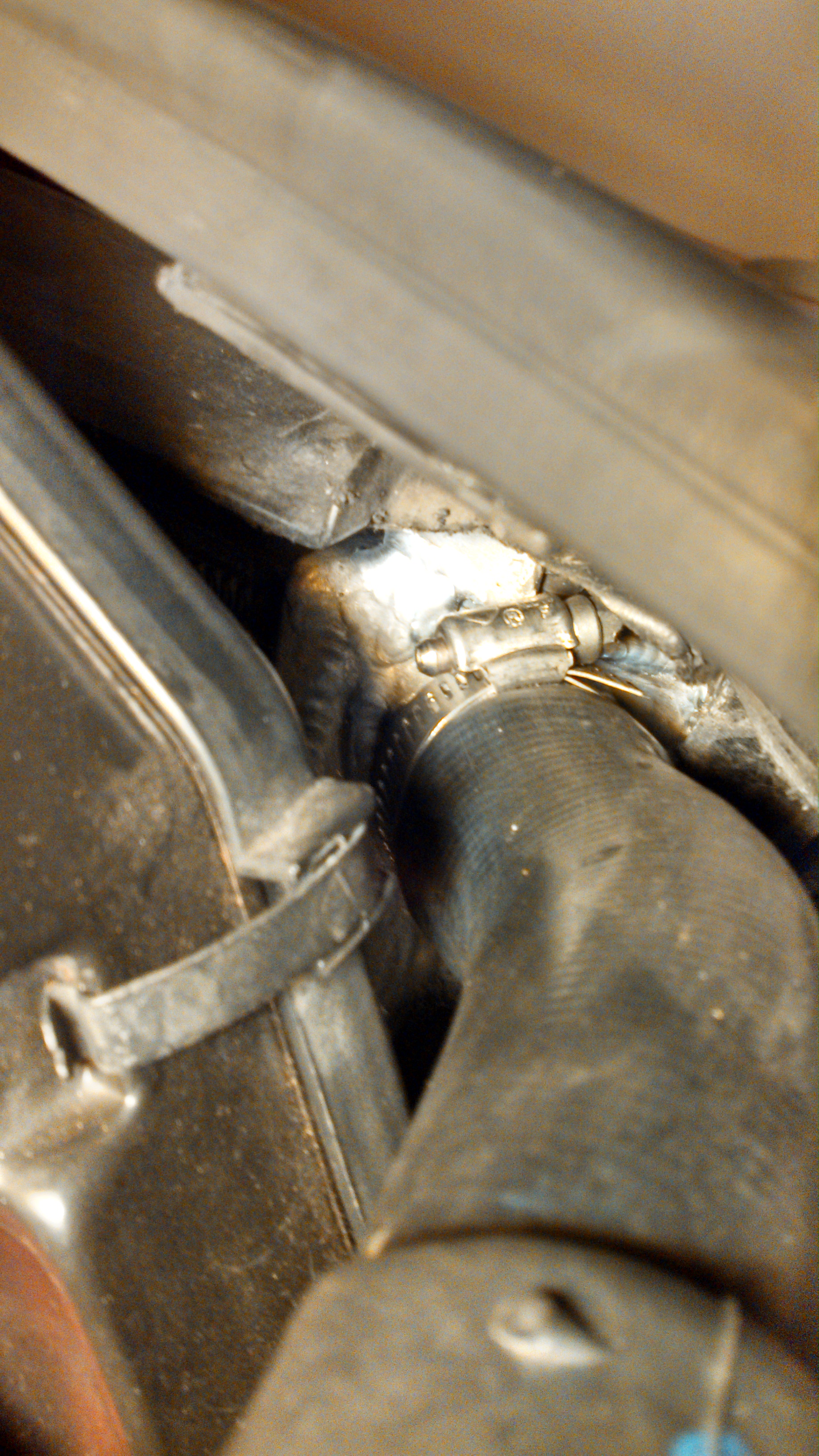

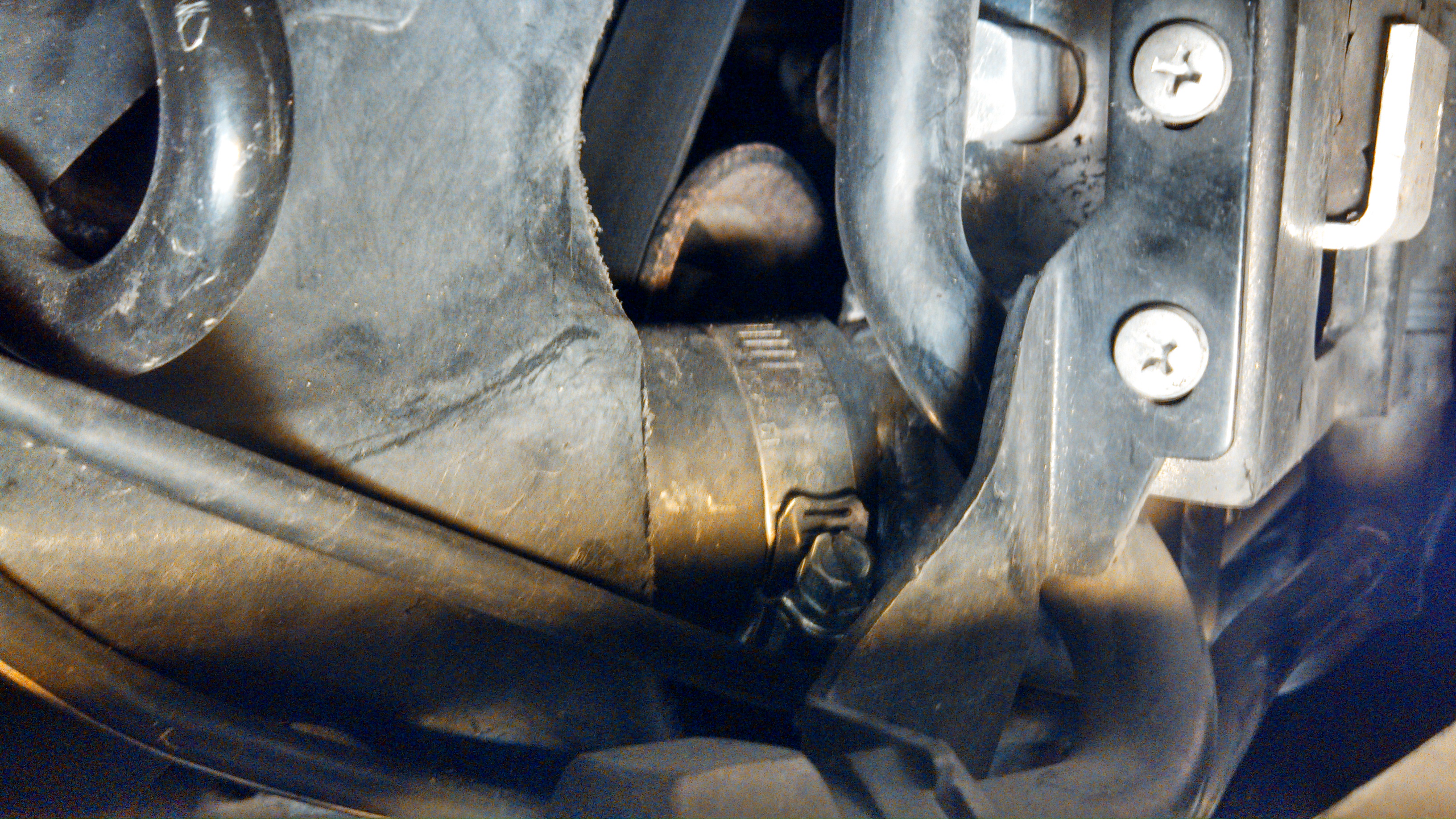

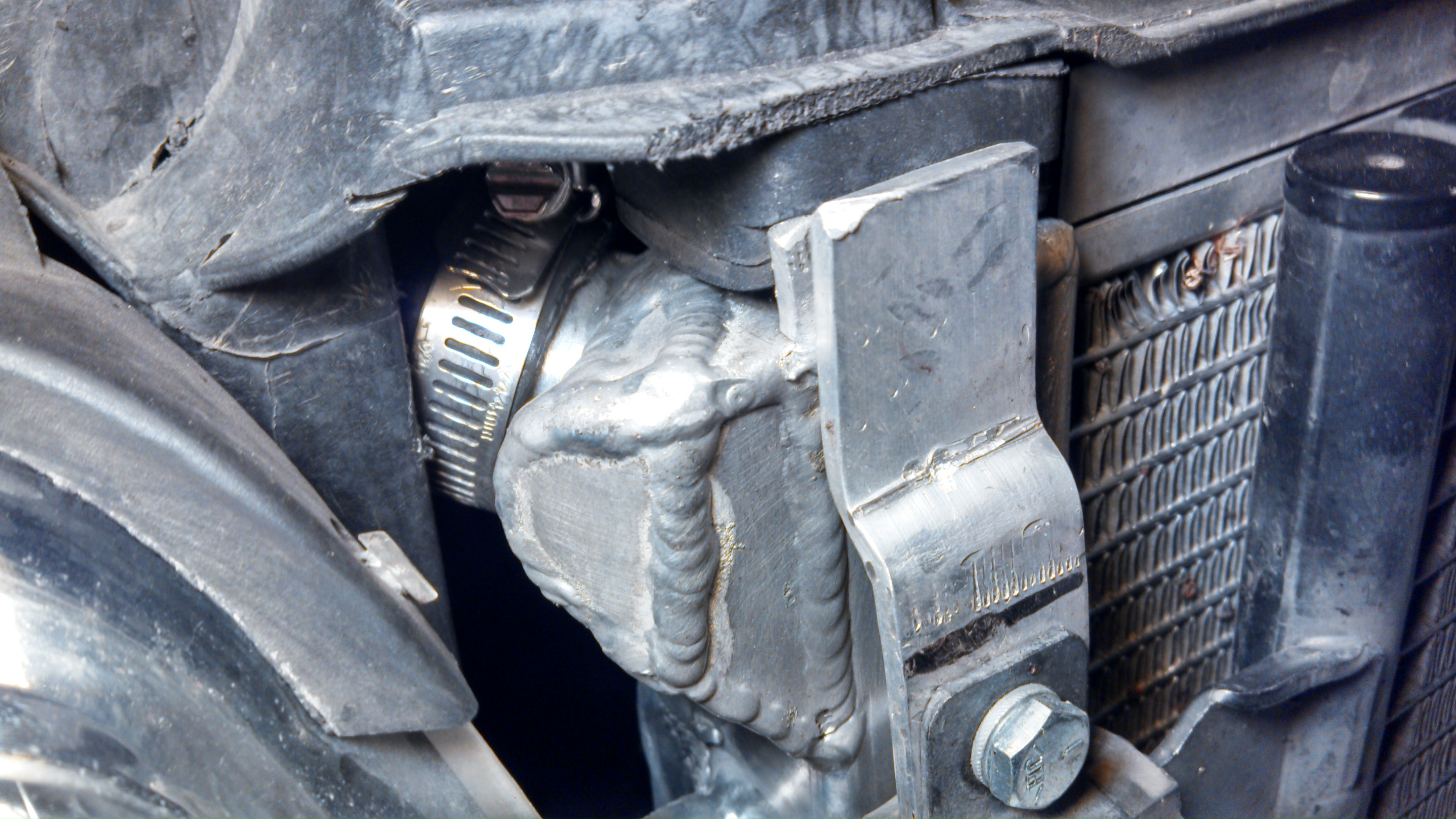

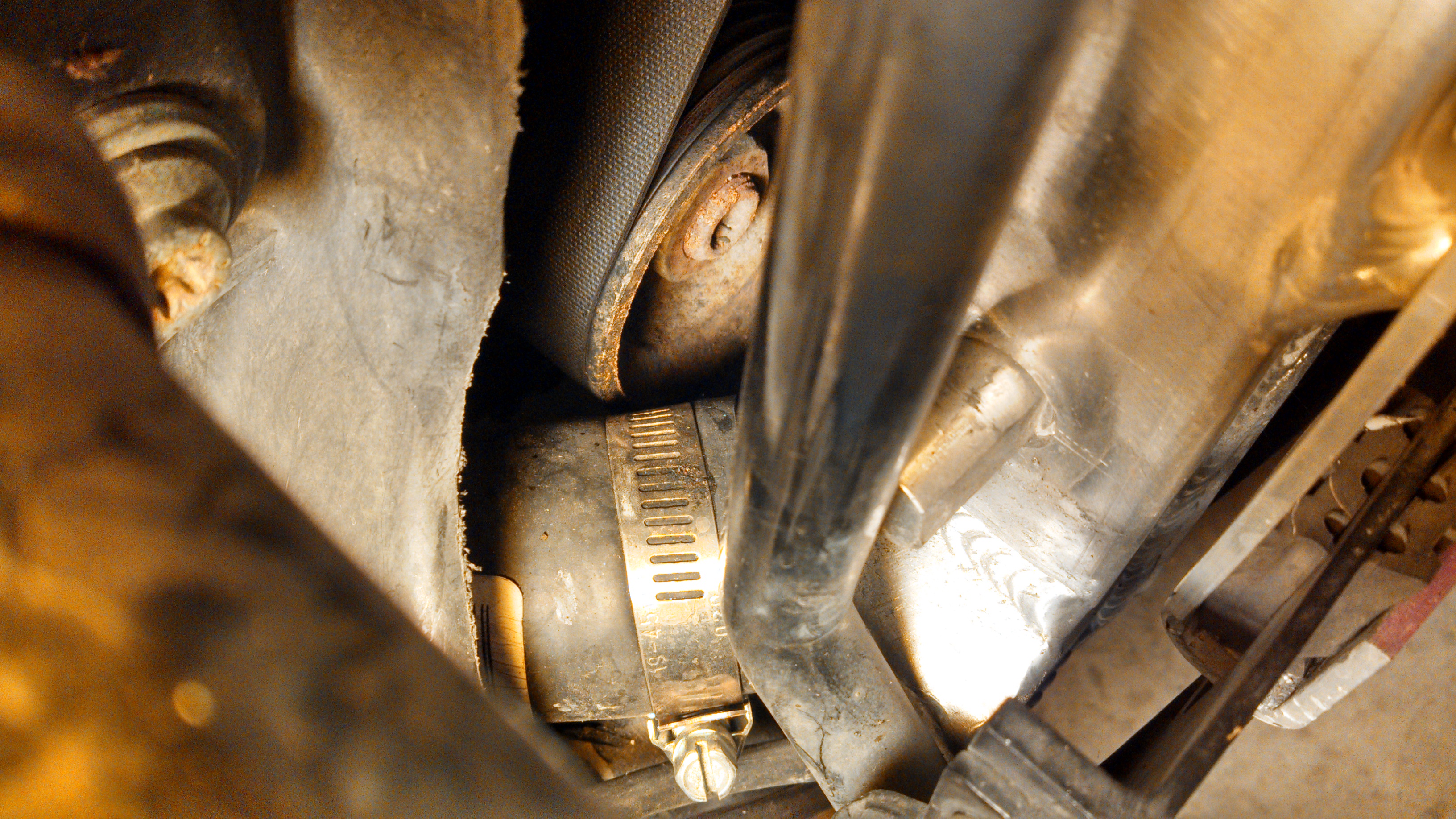

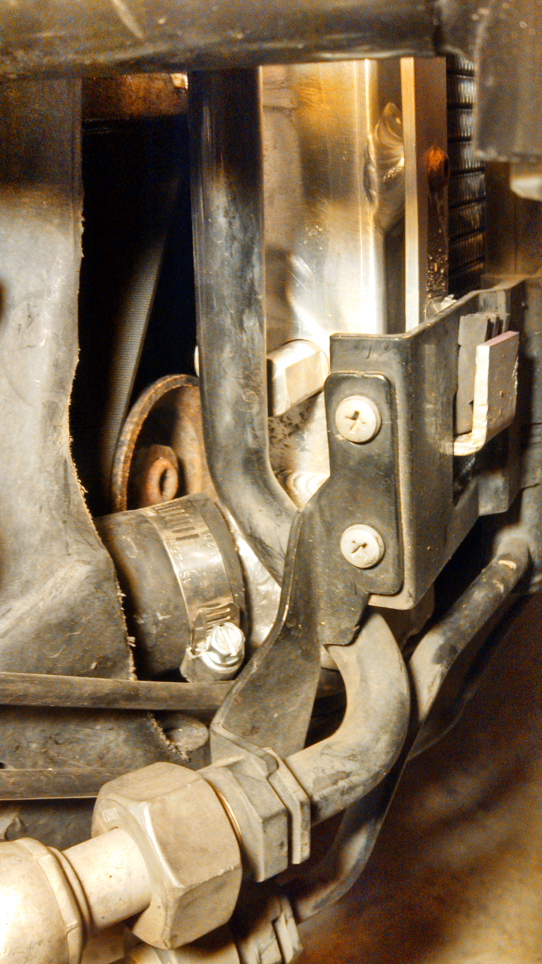

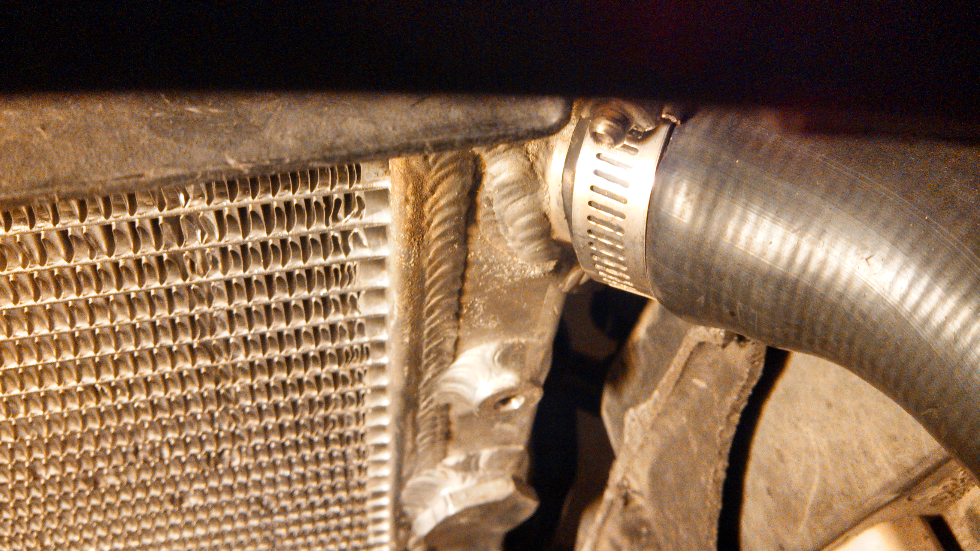

Got some time today to work on replacing that serpentine bearing that had gone bad. In the process, I took some pics of the radiator setup for those that had asked.
Top hose from outside:

Clearance from inside on the top hose:

Lower hose from outside:

Upper hose from inside after moving lock carrier forward:
