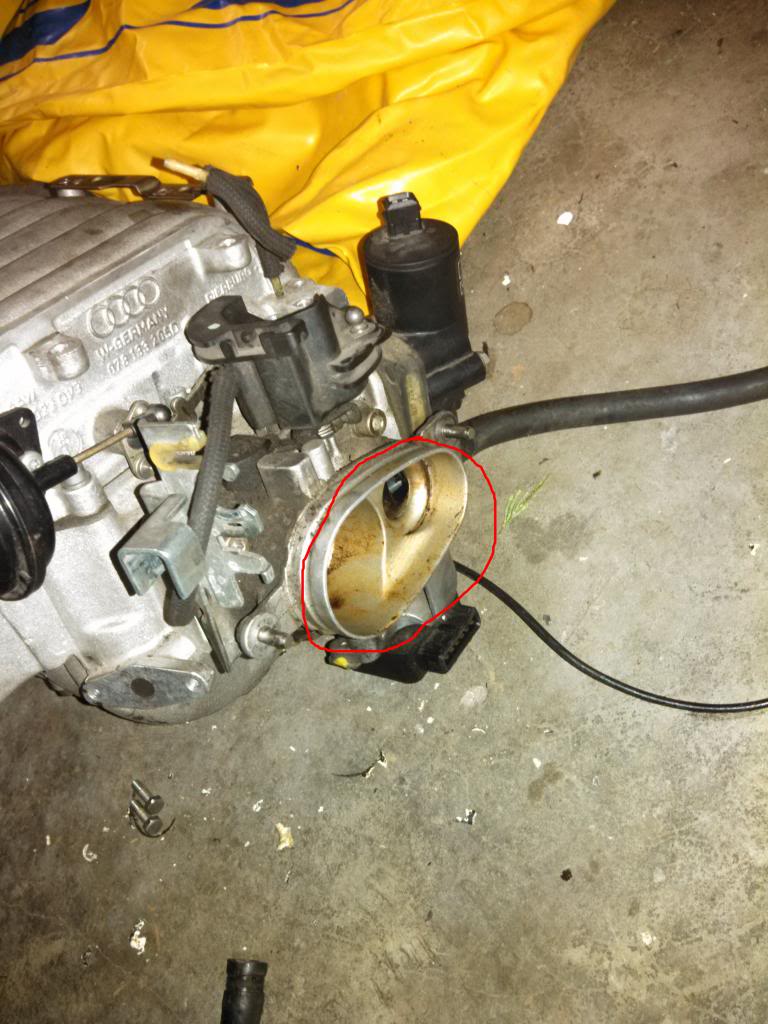

So i took off the intake manifold, and on the back of the throttle body, there is a black gasket that just sits there, it is removed in this picture:
Here i have inserted the gasket into what audi calls the "intake plenum", this is a very hard part to find and i have found very little info on it.
I sealed it with silicone and put in place. The engine feels like it is running smoother now. It is quieter, but i still have a CEL on. So the search continues!
