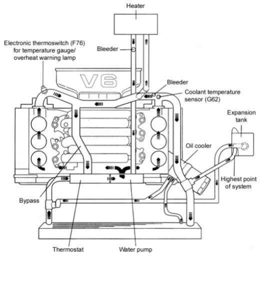

Ok this is the diagram so it show the flow coming through the block on drivers side and flowing thru the top hose and out the bottom going from the bottom it goes it to stat housing so the coolant still should go thru the hose but get stopped at the housing and not allow to go further so then with that said the house still should be hot going to the housing just not going past. So coolant is going in hot to the radiator but not coming out thru the other line. And ya I flushed it but that isnt going to get everything out of the radiator there's so many tiny passages. And the car warms up normally then it's starts to go up

It SOUNDS like your Tstat to be honest....like it's NOT opening.
Do you have HEAT when it's warmed up, before it overheats?

The blockage could still be a stat that doesn't open. If water can't get through the stat, then there is no reason for the radiator to be warm all the way through and the bottom radiator hose would be cold. There is no where for the cold water to go.
You're right, just because you have flow through the radiator doesn't mean there isn't some blockage in there. But it does mean that the lower hose should at least be warm.

you are right mtroxel..I had a clog once that wasn't apparent because there was no pressure on the system, but once pressurized the clog moved. It could still be the tstat, BUT i'm now more leaning toward a clogged radiator as well, what I know from other vehicle makes, if the bottom hose is cold and the top one is hot, the radiator is generally clogged....
