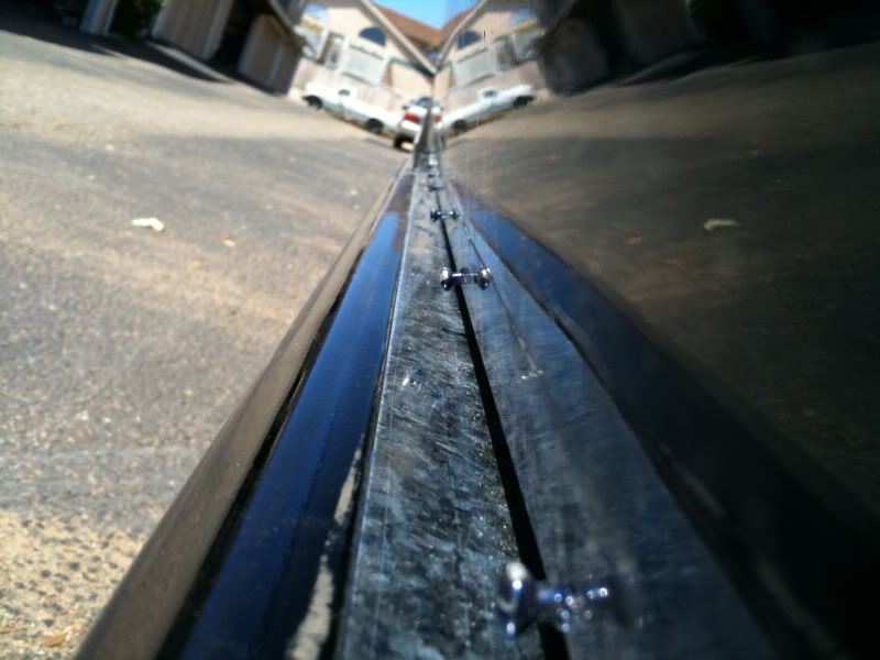

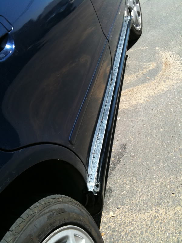

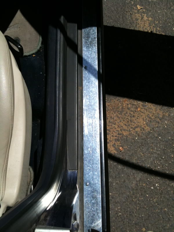

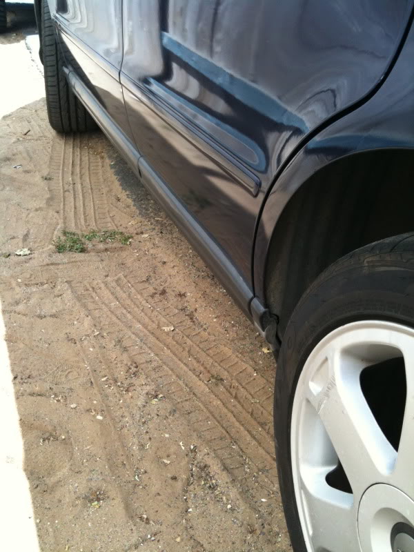

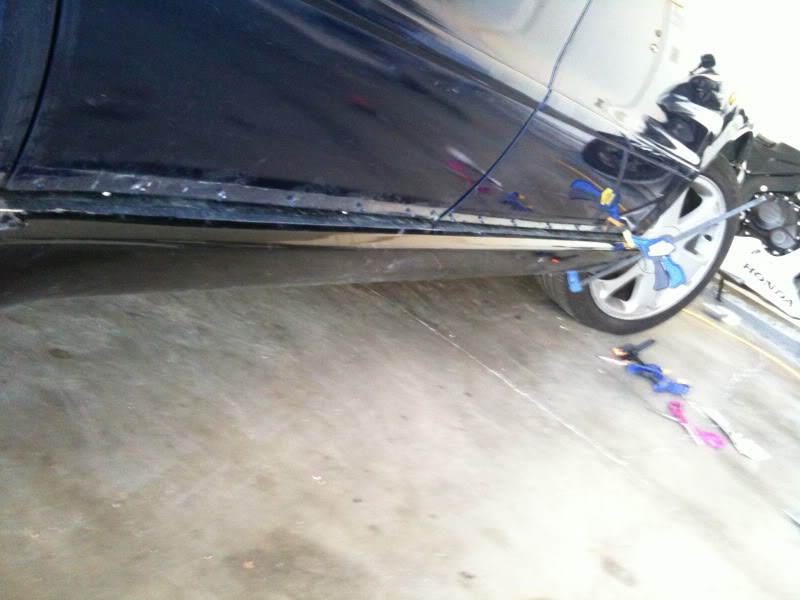

So i'm about to start my widebody and i got my sideskirts from my buddy's S4 but once installed they just looked a little too stock. The OEM rs4 skirts are wider than the s4's and look great so i decided to just modify my rocker panels. I found a few 10ft lengths of angled sheet metal and cut them to fit my stock rocker exactly. I ripped off the lower door moldings and grinded down the clip mounts smooth. then i just attached the s4 skirts to that for about an added inch. These are rough stages of the job but i will most likely blend the seam and clean things up a bit. i'll post more pics as things progress.

Sides lookin good! coulda just pulled off the doors lower strips and get the same effect tho! But ether way looks nuce!!
I pulled the moldings as well, but my fenders are coming way out so i wanted them to blend a "little" better
