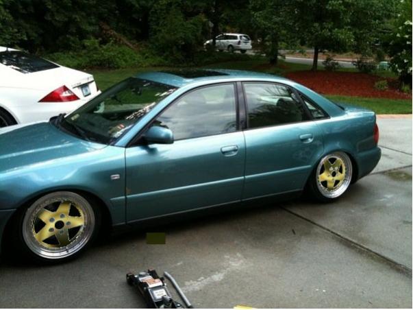

Just thinking about your wheel situation ever think about gold or bronze?
just a quick PS of what it may look like IMO I like it
