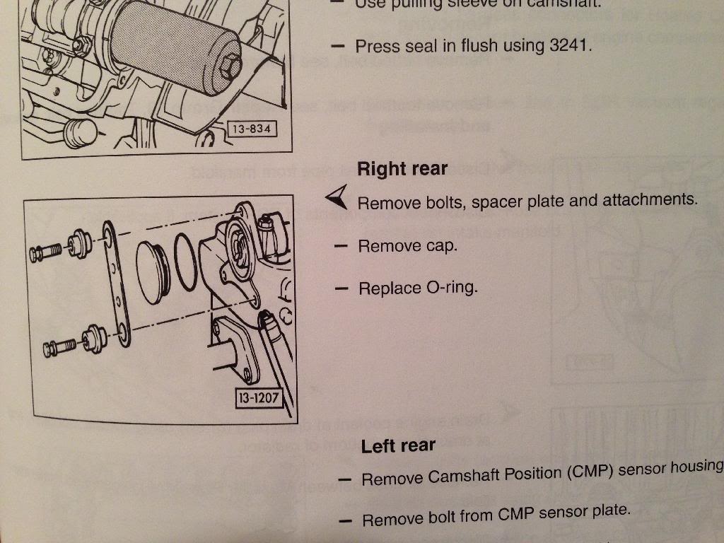

Started to diagnose a rather fast oil leak. Looks like it's coming from a plug on the back, right of the head, in line with the camshaft. Where can I get it (besides the dealer)?
^^^ Out of the Bentley manual.

Thank you! I looked all over ECS and couldn't find it!

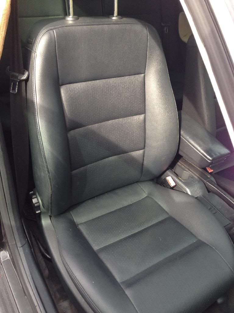

Got the driver seat recovered...

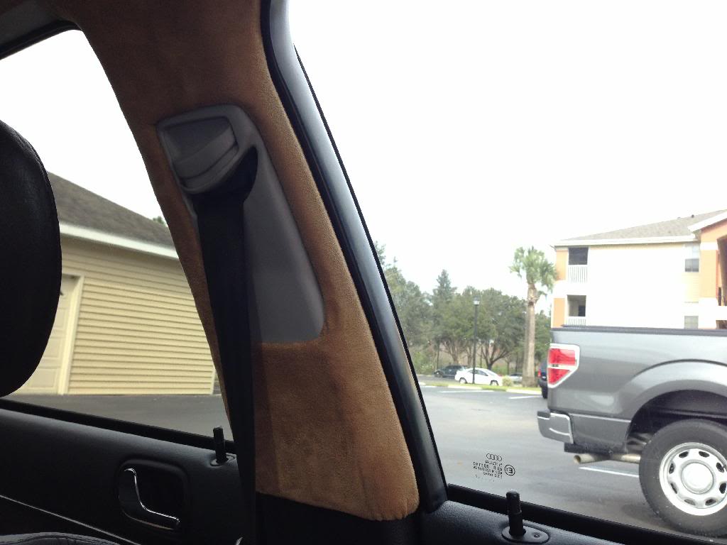

Had the B and C Pillars done too...
And the seats I got from the junkyard...

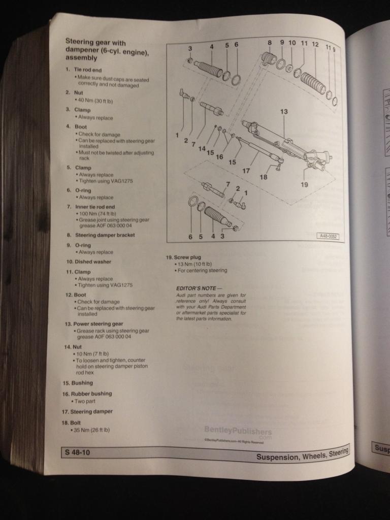

It's been SO LONG since I've been around, but progress hasn't stopped! I've done so much since I've been on last. But now I've run into a problem. Is there any way to replace the power steering gear without replacing the entire rack?? I've developed a massive leak, and we've tracked it to the gear (number 13), or of course if there's any way to rebuild it. Thanks all...
