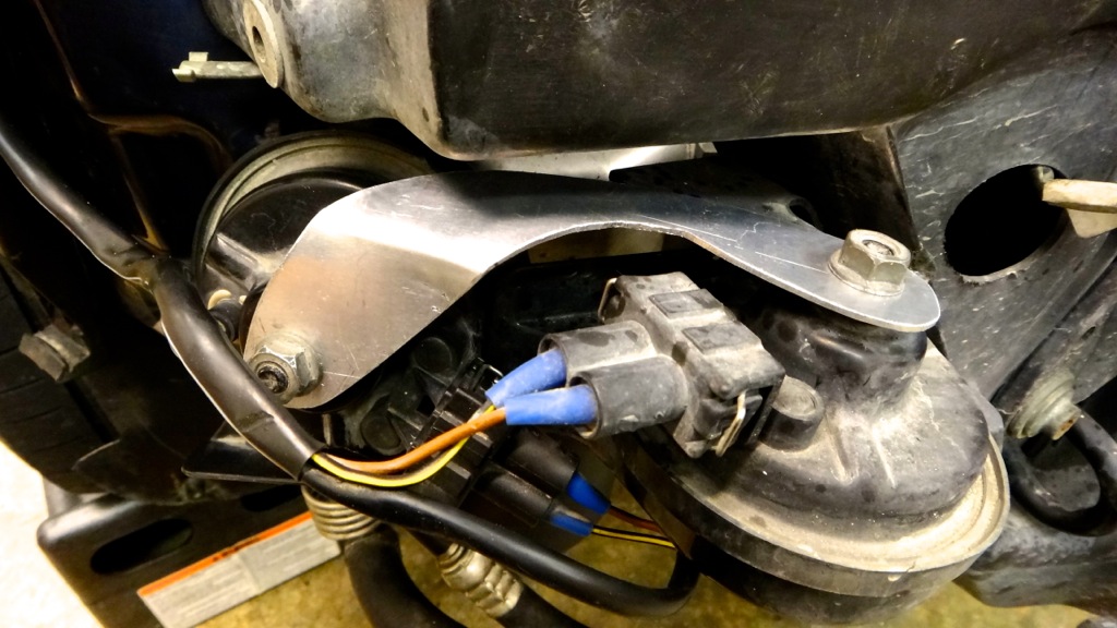

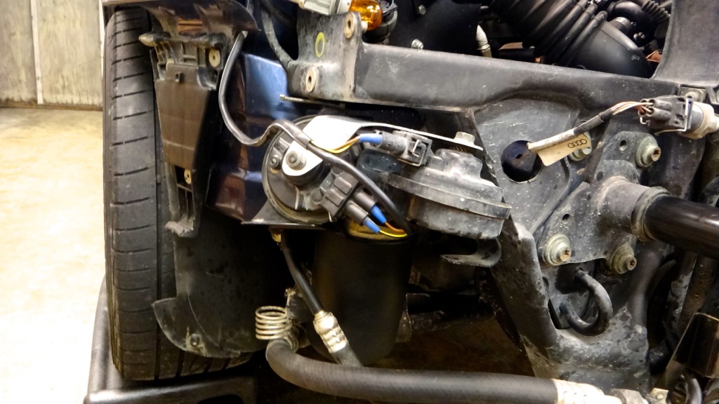

Ok, I got the fogs installed. But where do I put the horns??
Old Aug 24, 2013 | 01:38 PM
  #24
BaseDrifter's Avatar
Site Moderator/B5 Tech Guru
Joined: Feb 2010
Posts: 1,745
From: Bay Area, CA
Only the lower horn needs to be relocated. I found the best location to be behind the upper horn. I made a small bracket out of a piece of aluminum bent to the proper angle with two holes drilled in it. It connects to the bolt for the upper horn.

Got it, thanks! I just cut off half of the bracket that wasn't used. Will post pics soon.

How did you end up relocating the horn?

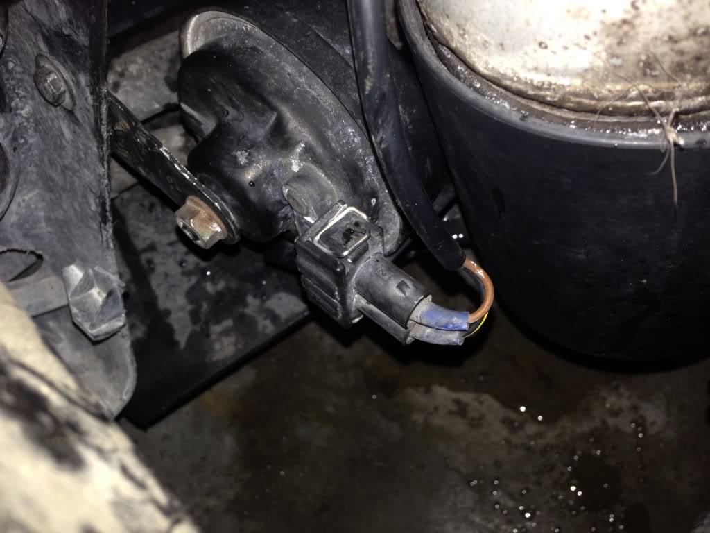

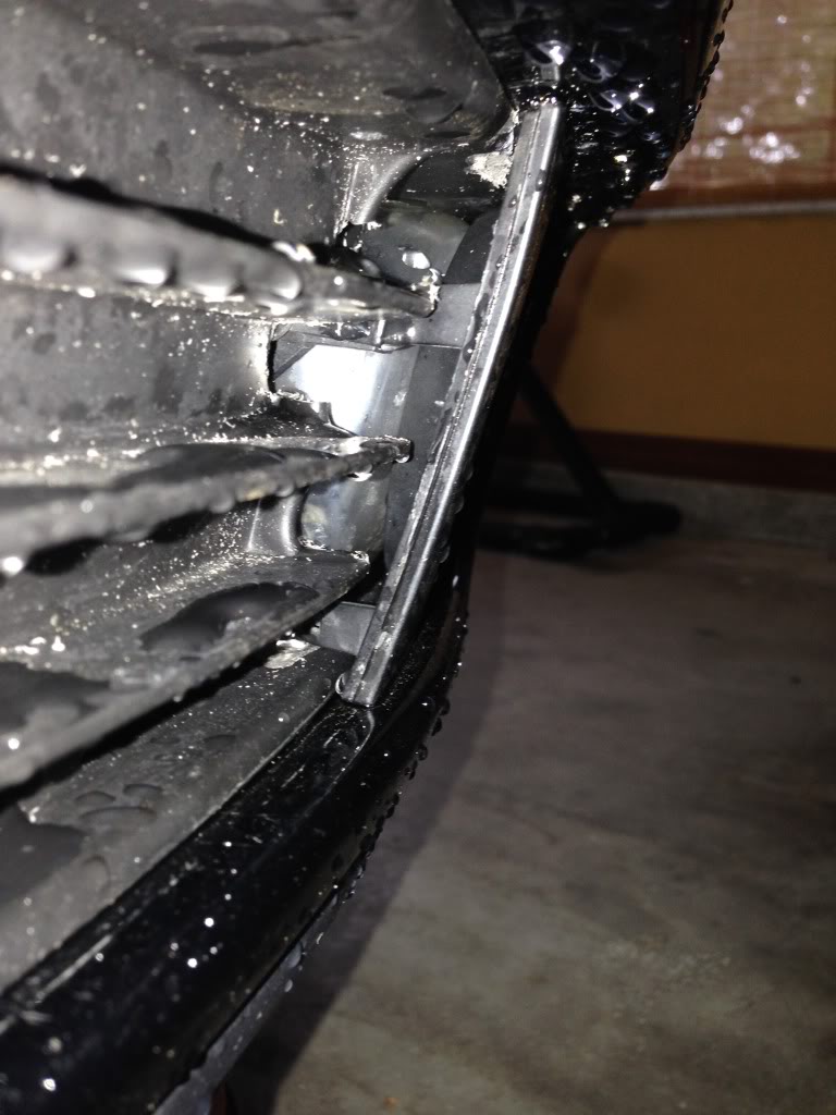

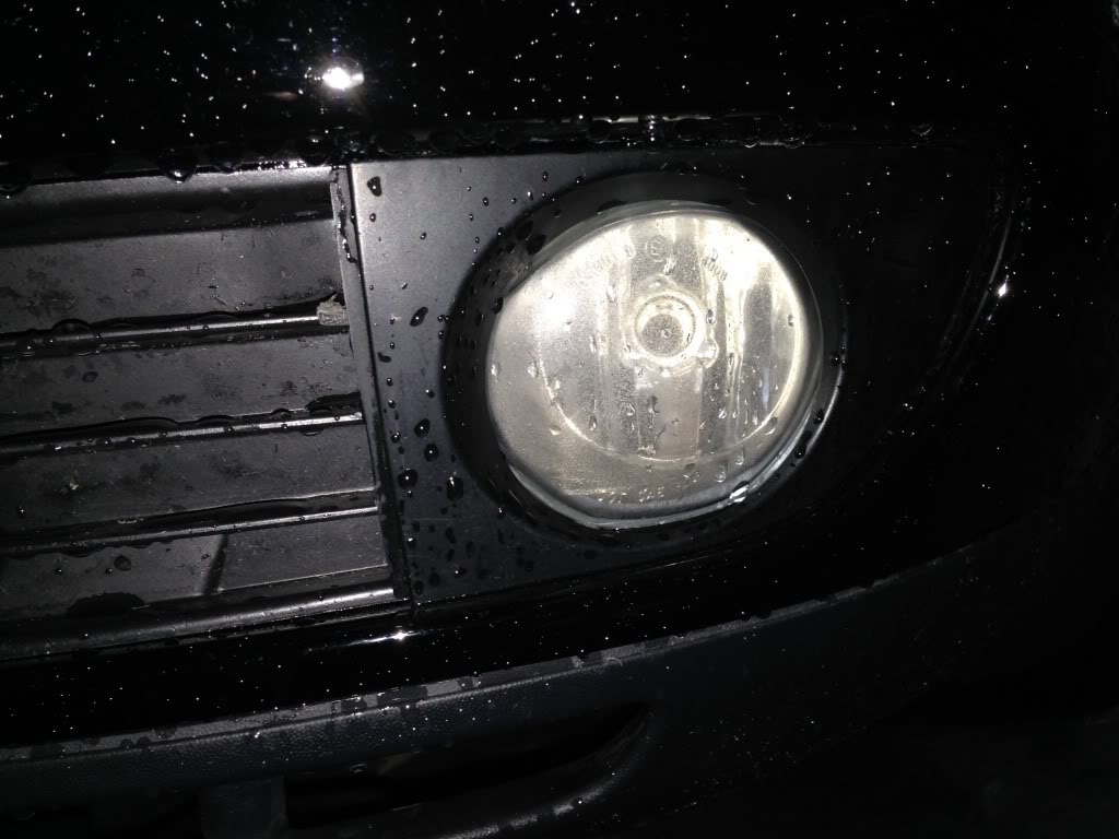

Old Aug 25, 2013 | 11:20 AM
  #28
Clayson's Avatar
Joined: Jan 2012
Posts: 214
I know the pictures are crap, but it's the best I could do without taking the bumper off!!
Basically what I did was cut the existing bracket in half, and moved the bottom horn up. There were already like two holes drilled above the existing horn, and I just moved it up there. If that makes any sense, whatsoever. Also, I have to admit that I didn't buy the facelift bottom grilles. You can kinda see that I dremeled out a trace of the fog lights. And I slipped in the light itself from the back, and clipped them together, squeezing the grille in between them. Turned out better than I thought it would!
