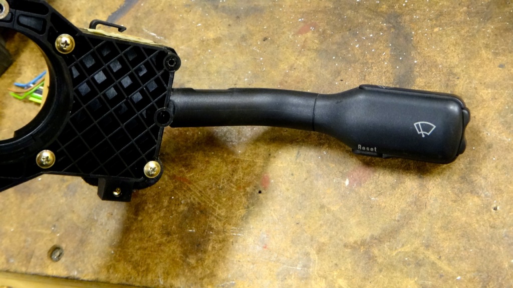

Originally Posted by Clayson
Wait, so the stalk on the '97 had the bottom and side buttons for the display, but no intermittent wiper control?
Yep, that's correct. Here's a picture.

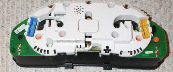

Dammit! Come to think of it, in the junkyard, I saw what I'm assuming was a '98.5-'99 without a LCD, but with the variable intermittent wiper control. What does the back of yours look like, this?
Yes. If you don't want to cut plugs off and solder a ton of wires, you'll need a 96/97 cluster with an LCD. 98+ has different plugs.

My first advice would be to invest in a Bentley manual. It was the single most valuable resource when I was doing all my electrical work. I spent hours studying the electrical diagrams to try and understand how everything is working together. Wire colors, pin numbers, and locations are crucial for attempting a swap like this.
You wouldn't need to actually cut the plugs off. You could go through and pull each pin out and insert it into the correct slot on the new plug (assuming the pins and slots didn't change between the two clusters.) We're talking about pulling at least 30 pins. I pull pins with a makeshift pin pusher made out of brass flat stock and some needle nose pliers. It's not easy and highly frustrating. It would probably be a good idea to spend the money on a pin puller tool set.
