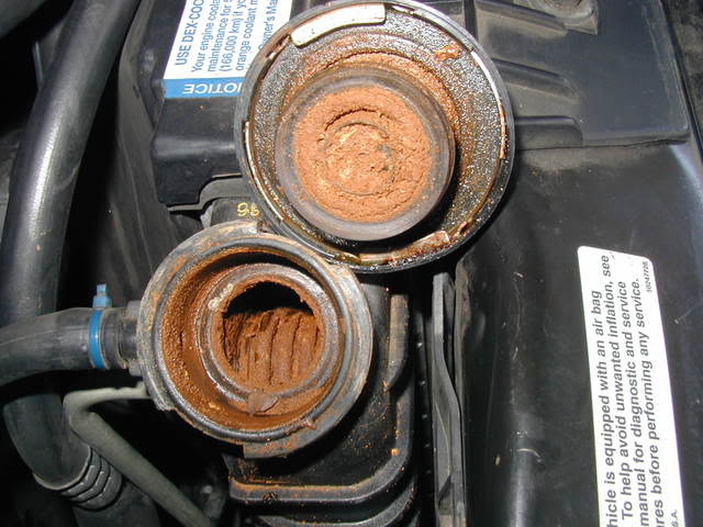

ORIGINAL: chaos92287
it doesn't suck. it just doesn't come anywhere near close to be safe to change it every 150k. thats just ridiculous.
15k miles on a Blazer cap:
50k:
The radiator:
Couple more:
I'm not a fan.
