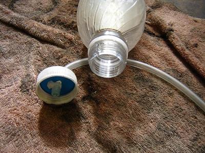

I am not familiar with your car but have been using the Motive for years and I really like it. I put the car on stands and take all the wheels off to gain easy access to all of the bleeder valves. Cover the area around the reservoir with towels to catch any spills. Next suck the reservoir out with a turkey baster or vacuum pump. Then I fill the reservoir about half full (above the outlet for the clutch master if you have one). Cover the area around the reservoir with towels to catch any spills. Pour the remaining fluid in the Motive bleeder (assuming you started out with a new litre of fluid). Screw the pump into the Motive bottle then screw the Motive adapter onto the master cylinder reservoir. You may have to roll the Motive around a little to get the hose kink free. Now pump the Motive up to about 15 lbs while keeping the bottle tilted toward the pick up tube in the bottom of the bleeder bottle. Now go around to each wheel starting with the furthest first (see the manual). I put a hose attached to a pop bottle on the nipple once I break it loose. Next, open the bleeder valve slowly until fluid is running out in a stream, keep it going until clean brake fluid is coming out with no bubles in it. At this point you should check that there is still pleny of fluid in the bleeder bottle. If not, read below about removing the Motive components without making a mess. If there is plenty of fluid, say more than half of what you began with, proceed to the next closest wheel and repeat. Each one will produce clean fluid sooner. Before you get to the last wheel, bleed the clutch slave first. At the wheel closest to the master cylinder (the last one) bleed it until clean fluid appears, then rotate the Motive bottle so the pick up tube is out of the brake fluid. This allows air in the bottle to purge the fluid in the line going to the reservoir, you can watch this happen. Keep this up just until you can see the level in the reservoir is at the Max mark, then unscrew the pump from the Motive bottle to relieve the pressure. If you skip this step you will have brake fluid all over place when you take the adapter off of the master cylinder reservoir.
I like to use the ATE Super Blue and Super Gold, alternating each time so you can tell when new fluid is coming out. (Paticularly for track cars that get frequent changes, you can't tell by how dirty it is.)
It is a little easier if you have an assistant who can monitor the bottle and pump it up if necessary. If you get a bleeder port that won't bleed by loosening the screw, just press on the brake pedal gently to get is started. This is rarely needed if the car has been maintained.
See the pic of the catch bottle. You don't need end of the tube to be in the used fluid as in the user friendly pedal pumping method.
