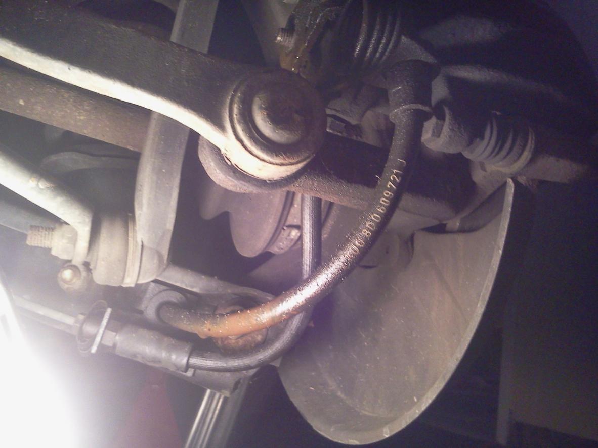

Thanks for the help guys but i had some time to take a look at it today and what i found may be a bigger problem then i initially thought. Both the lines and hoses look fine other than being old, but my caliper appears to be leaking and dripping onto the lines which i interrupted as a problem with my lines. where the parking brake attaches to the caliper there is a nut that is leaking. In the picture i have attached i have removed the nut from the bolt to show where the leak is. So now my question is there a repair kit for this type of leak or am i going to have to replace the entire caliper. Thanks again for any help

Maybe just a bad caliper leaking?
