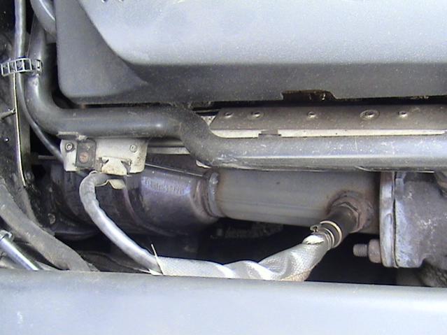

thank you, i have gotten this cat not to long ago,i say about 9 months ago. I just got my friends 97 a4 and the cat look totally different. I have picture of it attached .
