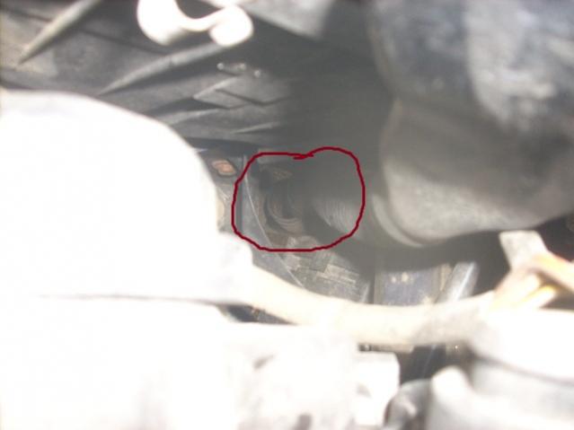

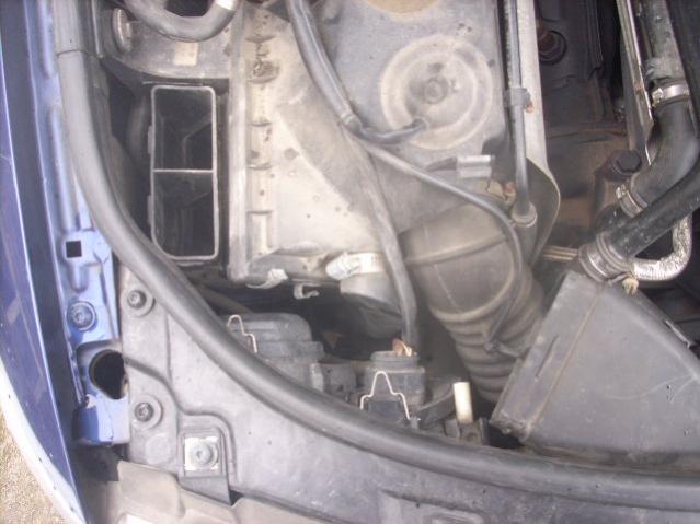

Here is a hose leading into the air filter....but as you can see...it's not connected!
How am I supposed to get my big mits down there to push it back in? Does the wheel liner need to come off, or hit it from below?

might be for the SAI... not too sure tho, my car doesnt have one

Seems like an SAI hose, but it looks broken and not disconnected. You can just take out the airbox to give you enough room.

That would be you SAI pumps intake tube. Its unmetered air, so you can just leave it as is, or pull the airbox out and fix it

thanks guys.......ya i just pulled the air box and noticed it was broken. Does this NEED to be attached or can i live without?

Just tape it up tight and you'll be fine.

Yeah buying a replacement for that would be a waste of money:
http://www.ecstuning.com/Audi-B5_A4-...ission/ES6606/
IMO, it needs to be fixed because that crack is letting unfiltered, unmetered air into your intake. I recommend electrical tape. Very high-tech

holy crap.....$90 bucks for that thing?? You can buy a lot of electrical tape for that!
