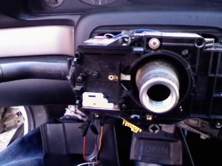

ok so I had to fix this issue last week and although there is a good diy on audiworld I'm going to help you out a bit. His directions for removing the wheel and trim pieces are perfect but you shouldn't remove the combi switch from the stalk. It just makes more work for you. once you get the steering wheel off (which takes maybe 3 minutes) it should look like this:
then you need to undo the medal plate with the four tiny allen screws and take the swith apart from the inside. it will look like this with everything removed except for the headlight contacts. (remember what it looked like so you can reassemble)

you will notice that your contacts both up top and on the bottom of the switch are covered in crap and will need to be cleaned and scratched with steel wool or sandpaper.

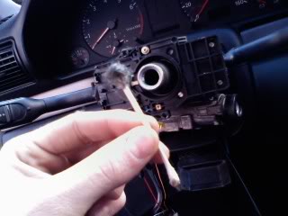

to clean the contacts just wrap some q-tips with steel wool like so

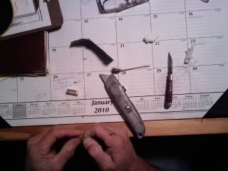

the copper contacts inside of the plastic housings will need to be cleaned and the springs that push them out will need to be stretched out
check to make sure nothing has melted and gotten in the away of the copper pieces. They must be able to leave the housing and make contact with what you cleaned back in the switch. If you had a bad connection due to the crap build up there is a chance the resistance caused enough heat to melt the plastic, and if it did, just sand it down.
