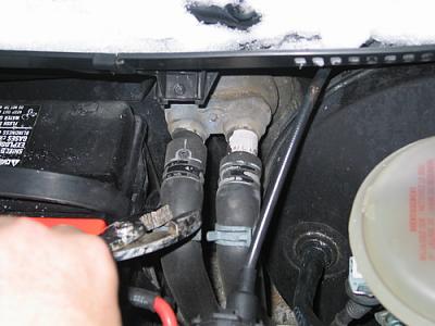

Does it smell like coolant when you're running the heater?
You can check your heater core flow with your hand on the hoses (they are located in the middle of the firewall behind the engine) They are two small hoses (maybe covered with plastic), one is in and other is out...I THINK the one on the left is IN and the one on the right is OUT, when you're looking at the engine from the front, I don't remember....the IN will have a STRONG flow and the out either none or a trickle, then you'll know your heater core is bad....you can also TRY to flush it out with a garden hose.....I had luck doing that ONCE.....otherwise, to replace the heater core, it takes about 4 hours to remove the dash to get to two screws that hold the heater core in...also, your AC will have to be discharged and recharged to do this job.....
I'm attaching a photo of what those two hoses look like, after the plastic cover is removed (that is if your cover is still on...).
