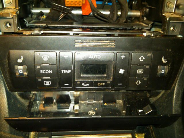

I'm on a trek to change my Airbag Module. and I'm stuck trying to remove the climate control. I'm pulling on it but it ain't moving. I don't want to break it. Take a look at the picture and please respond. thanks

try to take front off climate control unit to revel bolts held on with clips ashtray will have to comeout aswell make sure battery is disconnected trim by handbrake has to come off as well there may be two bolt above ashtray.

There are two bolts above the ash tray, that can't be reached until the climate control is removed, but I think they hold the console in. I've disconnected the battery, the center console is out, trim around stick shift is out, and I don't think the face of the climate control comes off, I think the entire unit comes out. So, I'm still looking for the 'trick' to removing it as a complete unit. Thanks

i changed my air bag module about two years ago i will check tommorrow , you need to take out ashtray as well

i found a site that will help type[ audi a4 b5 articles in google, they puhed a flat screwdriver under the control unit to remove unit but check the site hope it helps

I got the climate control out!! what a bitch. Cheers
