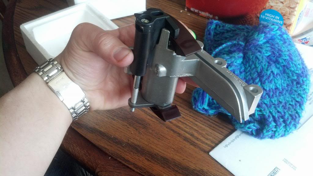

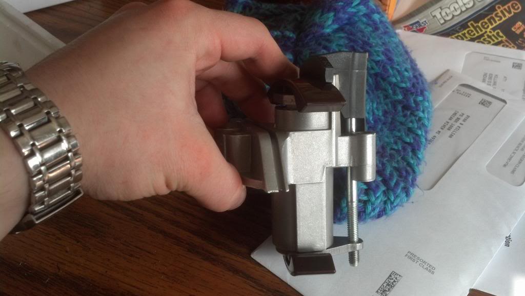

The tool compresses both top and bottom pads, as seen in photo. Just an extra cam tensioner I had lying around. It is compressed fully as you can see.
