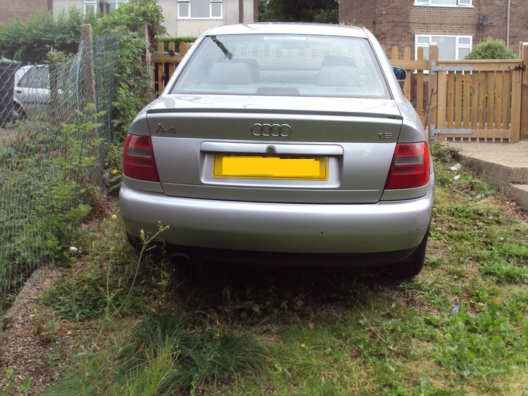

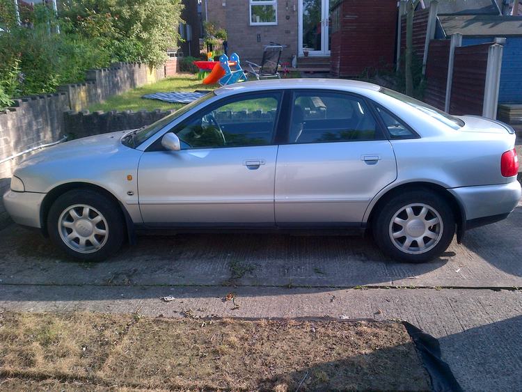

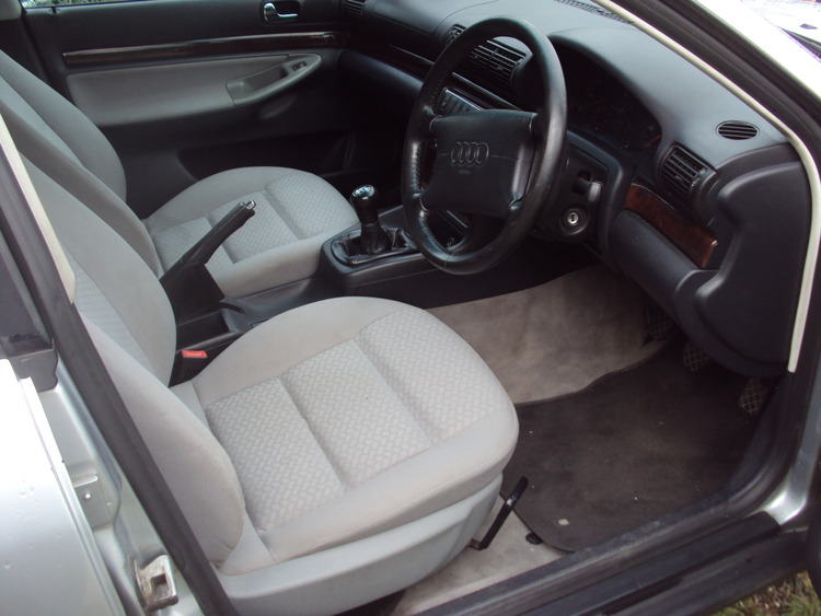

ah i get you never seen a engine with both befor, heres soom pics if this works

Looks nice, so peculiar to see RHD though!
