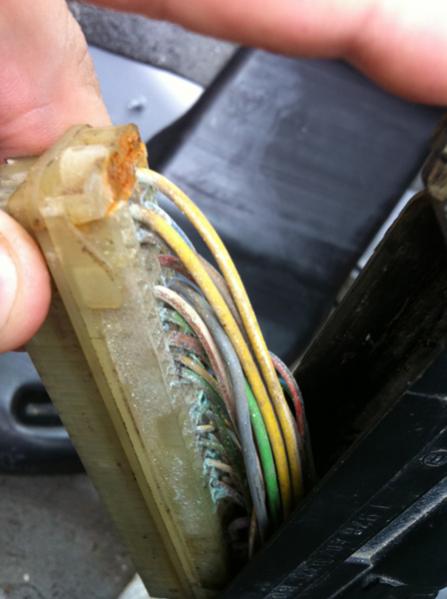

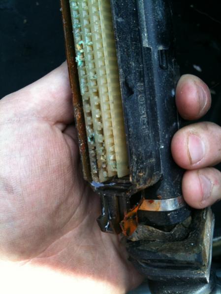

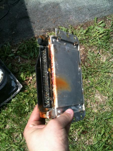

The reason why i had to replace the HOLE transmission harness is because of all the curosion in the tcu connecter, so i cut a wire going to the tcu to see how much there was and all i could see was green. So here are some pictures i forgot to put up from the first post.
Attached Thumbnails k04 upgrade-img_0738.jpg   k04 upgrade-img_1439.jpg   k04 upgrade-img_0736.jpg

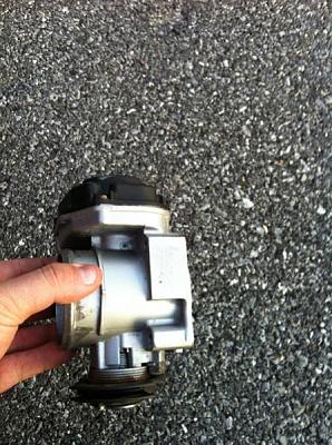

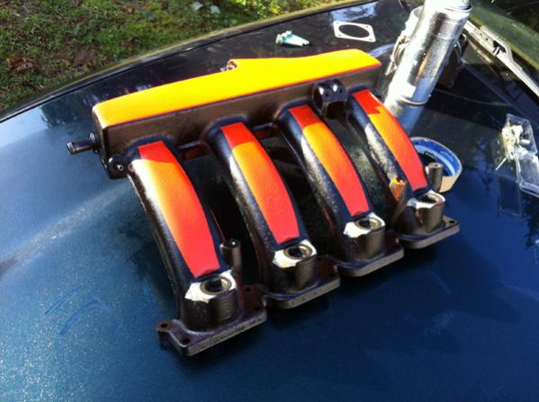

Throttle body cleaned
Attachment 11957
throttle body painted silver(so it looks factory)

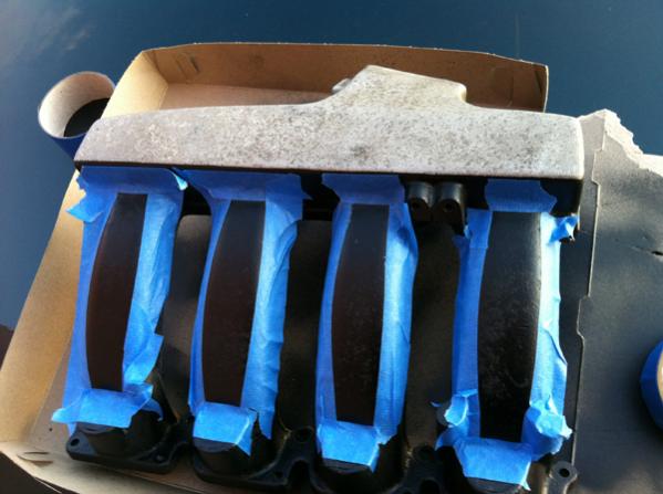

Intake manifold taped ready for paint
all done with throttle body on

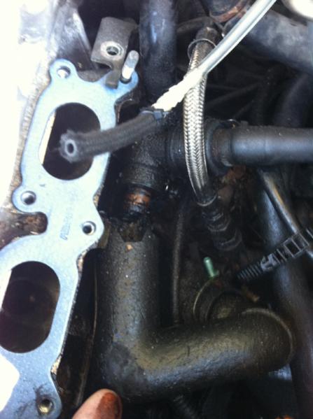

This is the piece tht was separated

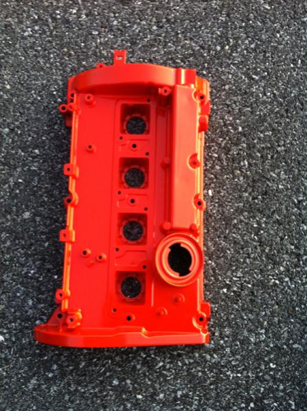

valve cover painted
