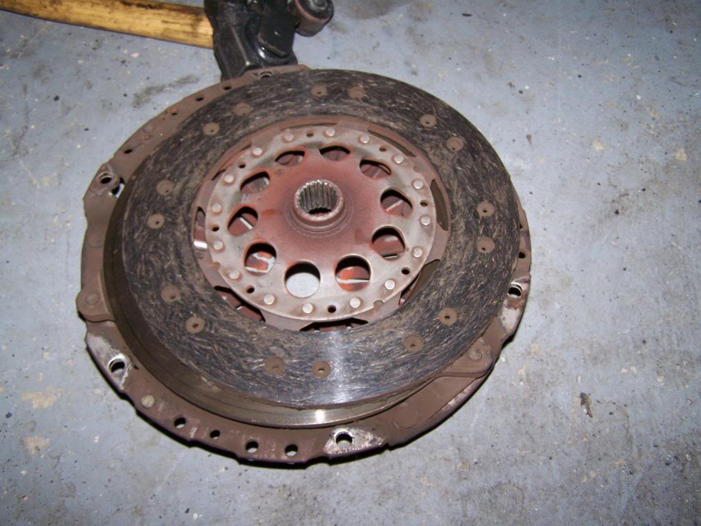

Finally got around to it this week; at around 156,000 miles we finally put her up on stands and swapped out the clutch. And not a moment too soon! The one we removed was apparently the factory clutch, and had definitely seen better days - the clutch surface was smooth as a baby's ***. It probably didn't help that the prop shaft seal was leaking transmission fluid all over the clutch!

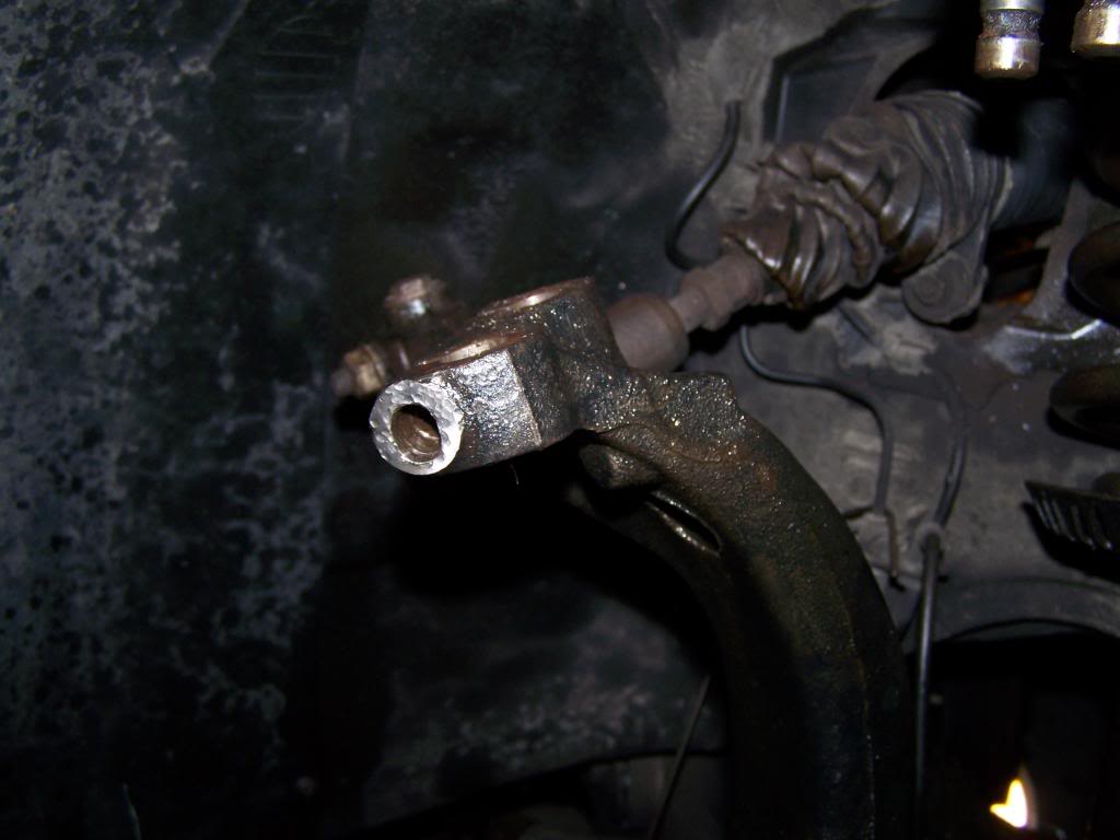

Passenger side upper pinch bolt was seized, took about eight hours of hammering and pounding, penetrating oil, torching, drilling, blood, sweat, tears, cigarettes and copious and unrepeatable cursing and swearing to get it out. Also, you can see the twisted steering rack boot.

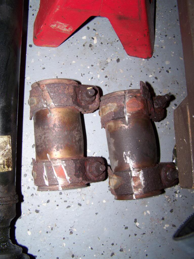

Exhaust band sleeves were rusted and had to be cut.

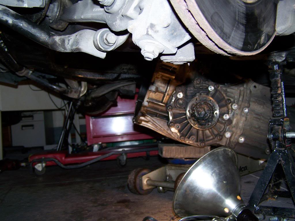

Finally got the transmission down.
Old clutch out!

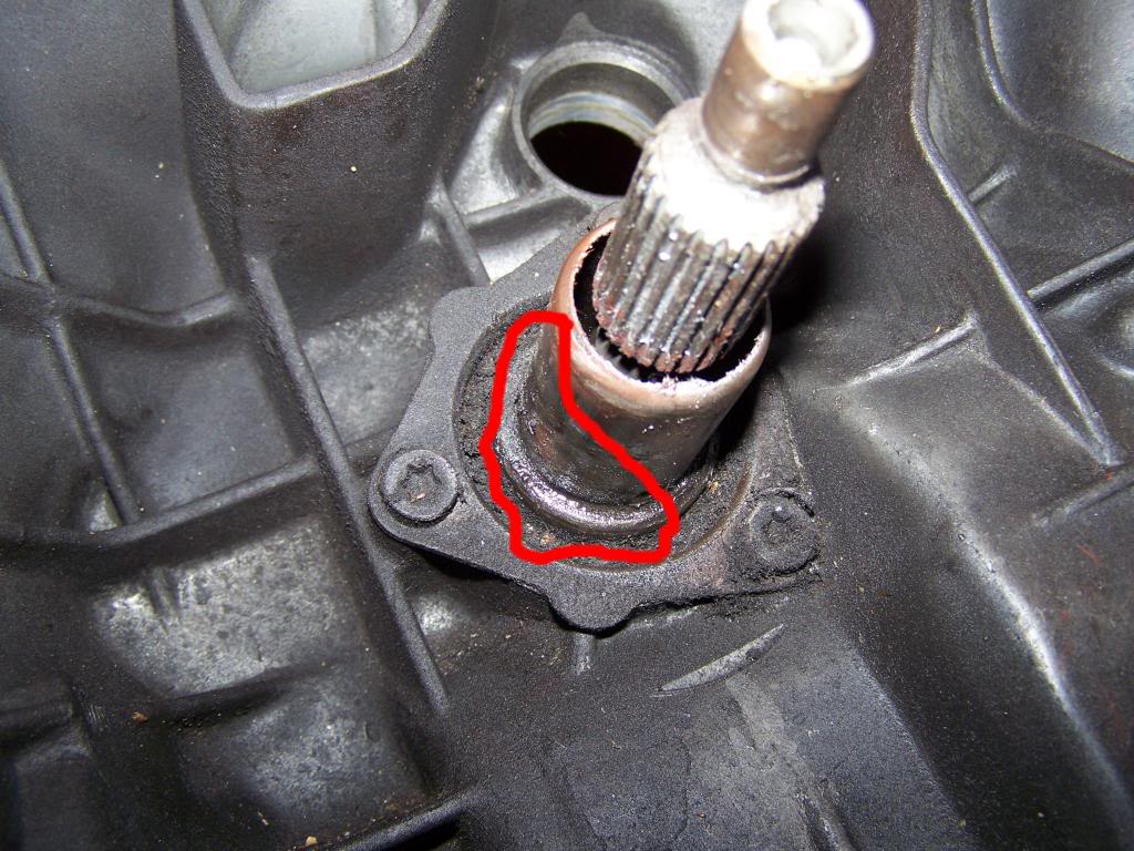

Pilot bearing ground to oblivion, and leaking input shaft seal. Both were replaced.

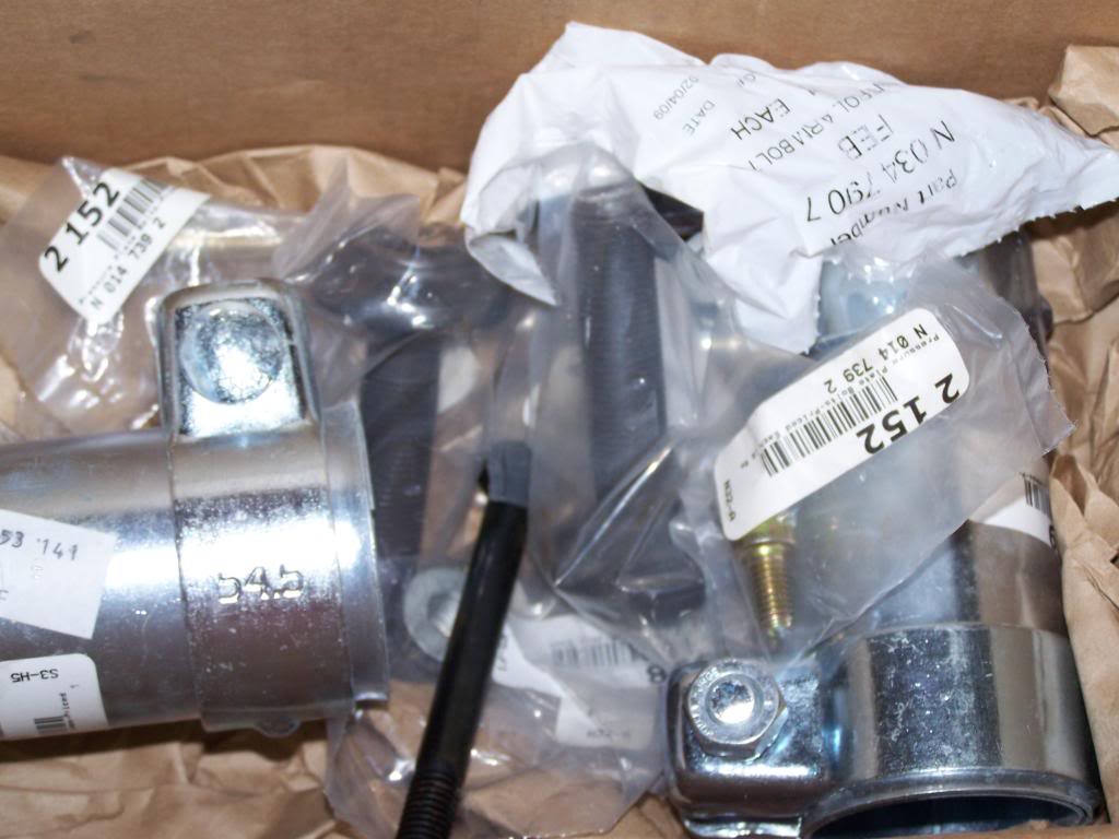

Box of replacement parts which were installed.
Old clutch out!

I haven't priced PCV parts just yet, as I'm not going to buy them until my next paycheck. Feels like a whole new car - the old clutch didn't grab until I had the pedal about 3/4 of the way up off the floor, so I had adapted a driving/shifting style which worked with that. Made for some unbelievably smooth gear changes, but the slipping meant that even accelleration on a level surface was poor (even for a 12v) and I frequently needed to downshift to go up any self-respecting hill.
New clutch is nice and grippy, grabs just after I let the pedal off the floor, and car puts power to the wheels much more willingly.

The pinch bolt can be a lot of work. You get good at taking them out though once you do a few times. Air chisel works the best from my experience. If you use a normal hammer it will mushroom the end of the bolt making it even harder to get out.
